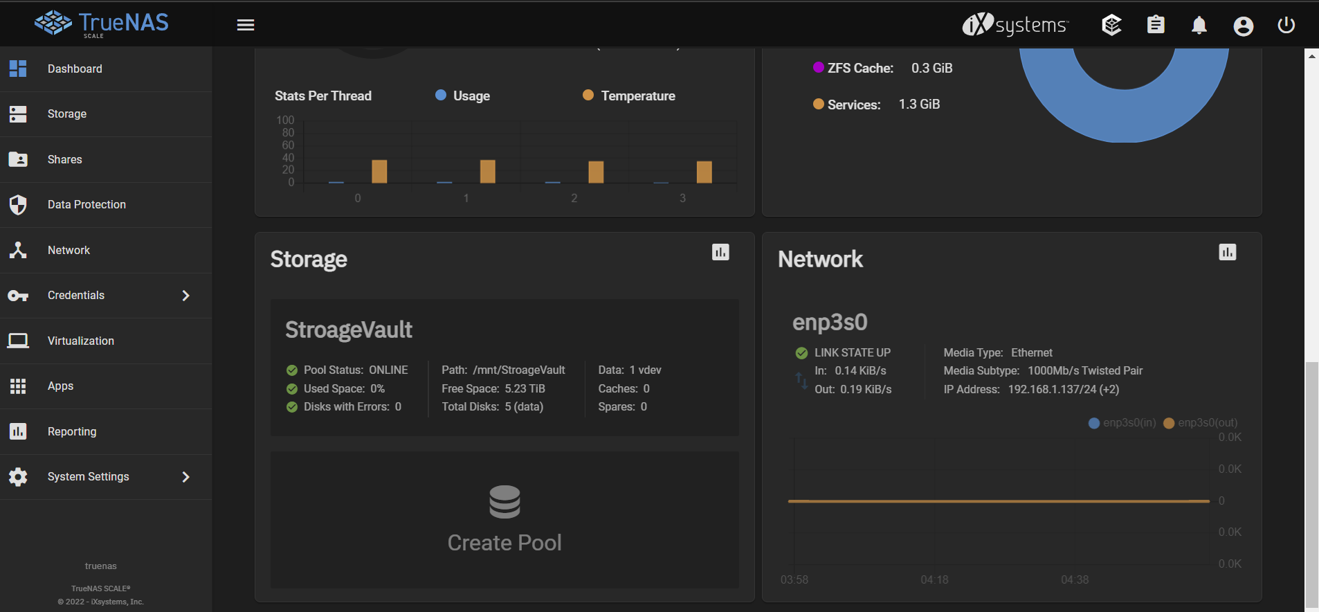

I have five 2-TB drives installed on my home server that means I should be seeing 10-TB of free space correct?
I uploaded a few of my YouTube videos just to see how much space it would use but I'm not seeing the full amount of my installed hard drives on my server. It shows Free space. 5.23 TB and Total Disk 5 (data )
Shouldn't I be seeing 10 - TB of Free space? I did not upload anything except those few videos
Hope I'm explaining this correctly and Thank you so much for your time I attached a screen shot of what I'm seeing in my dash board

What would help us to see the details of your pool would be if you go to the Storage | Pools page, click the cogwheel to the right of the screen on your pool and select Status.
There we will see the pool layout, which I imagine from your description of the hardware and what we see above will show us you selected to have RAIDZ2, which is a perfectly reasonable choice, but gives you only the available storage from 3 of the disks (which is also measured in TiB, so shows as smaller than you see written on the packet, which is TB).

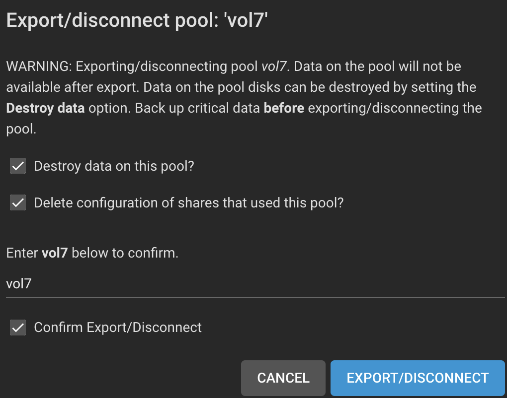

You get to destroying a pool via the Export/Disconnect option from the cogwheel.
If you select the option to destroy the data, the disks will be wiped.
I'm sure there was an option in a previous version to select if that wipe would be a full erase/overwrite or a quick one, but seems no more.

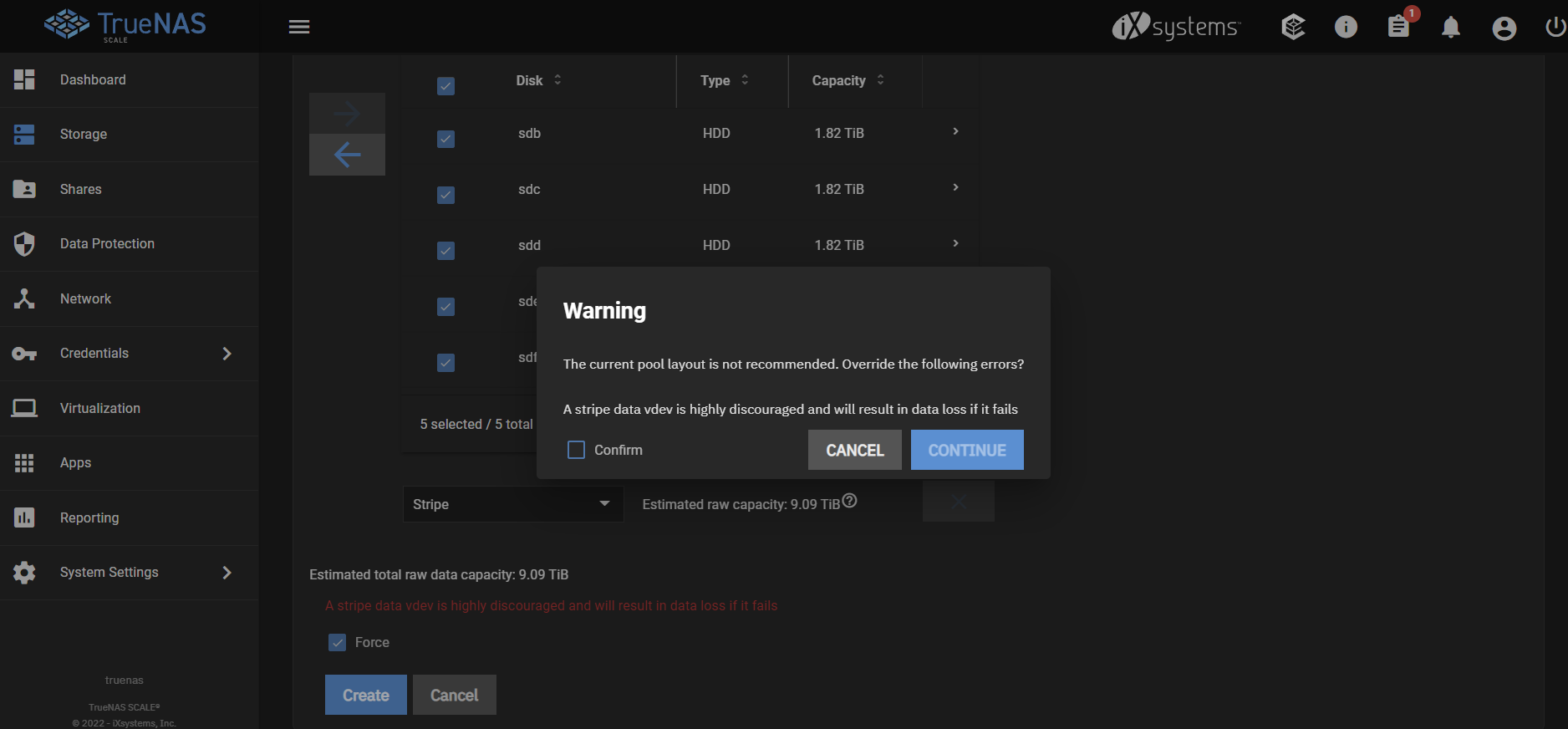

When I tried using the Stripe VDEV type
this is the message I am getting see the attached image below
9,700
That's exactly the stuff I was mentioning above.
If you're OK with the risks like you seem to have been, tick the box and continue.
