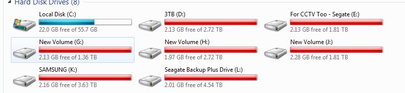

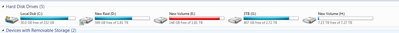

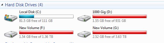

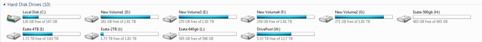

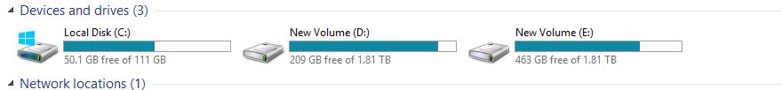

I have two camera servers running 24/7 & they require the most storage, I have a windows 2012 server which primarily handles the nightly backups of the comptuers in my home. Nothing is mission critical but I have copy after copy of data – it is not organized at all. If I see free space I dump things on it. Not a great way to manage it.
I am debating on if I should do a larger 2TB (8 or so drives) for Freenas, or reuse 3 of the 4TB drives and buy 3 more 4TB for a total of 6TB . I would prefer to buy better server hardware & replace drives in the future. I would appreciate any feedback.

How many drives maximum do you want to put in your server and how many space do you need?
solarisguy
Apr 4, 2014
1,125
To [B]RichTJ99[/B]:
Nobody knows your data better than you, but I can see, from the pictures you had posted, that if you envision data growth, you may want to have 6 drives 6TB each, or even 8 drives 6TB each, in RAID-Z2.
As I wrote elsewhere earlier, please reuse your existing disks for backups.
Also, user [B]Bidule0hm[/B] has developed a tool http://biduleohm.free.fr/zfsraidsarc/ for calculating usable space on ZFS pools. You should try it, to learn how much disk space you can really use for any given number of disks, depending on their size.
