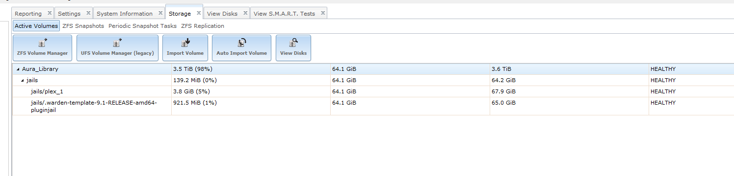

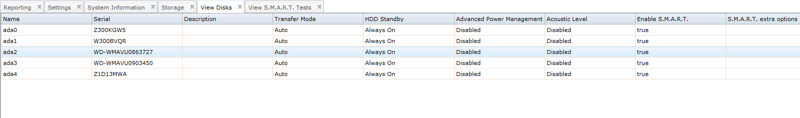

Is there anyway of treating ada2, 3 and 4 like external drives so that I could remove them from the FreeNAS system then use a external hdd usb enclosure to transfer the data back???

Ok, so I decided to extend my volume with my additional 4 TB and remove the other hard drives from my system. When it comes time to upgrade to RAIDZ2 I will just copy as much data as I can to my old drives via ftp and hdd to usb interface from my laptop. It will be slower but its ok, I thought maybe there was a way just to house the HDDs within my FreeNAS system to make these transfers faster. Ah well.
