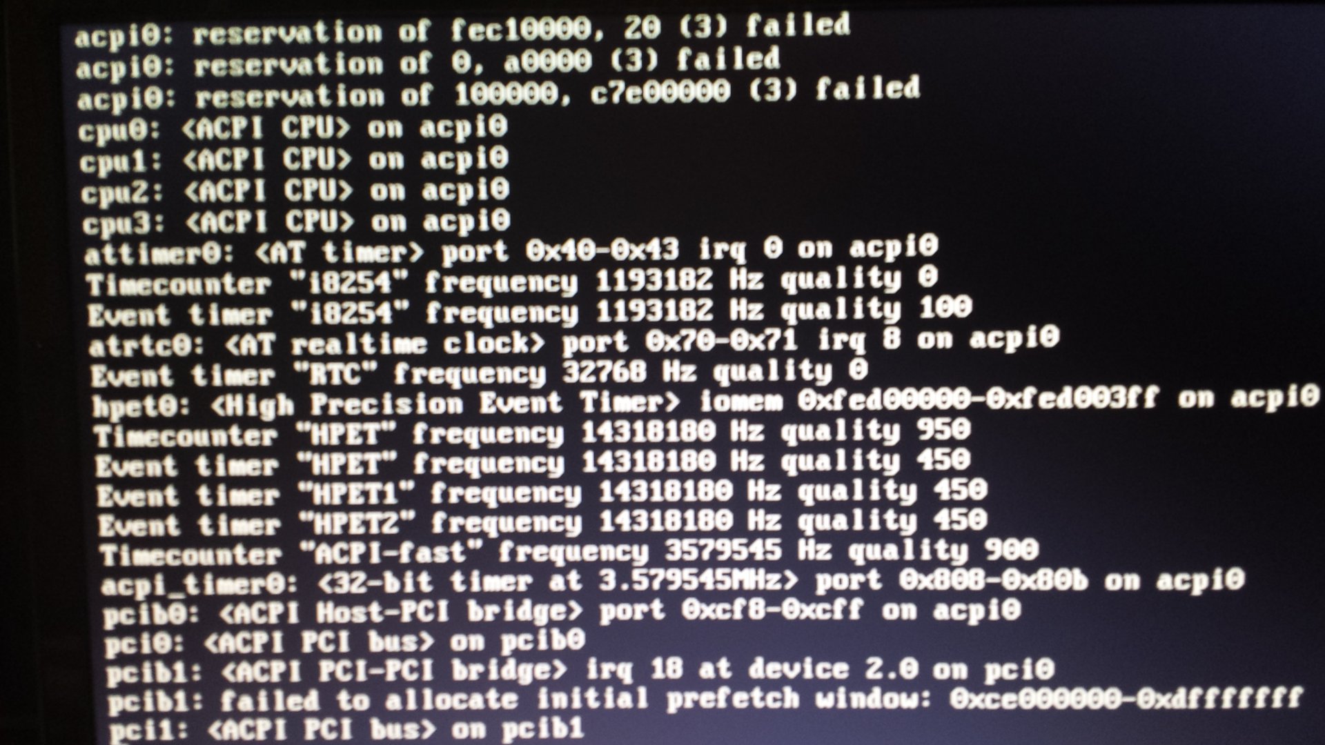

Hangs at pci1: <ACPI PCI bus> on pcib1
Malita
Apr 20, 2014
9
I'm trying to install FreeNas (64 bit) on a HP HPE-130F system that I had lying around. I recently bought a WD Red drive for storage. No other drives or OS installed.
At first, I was stuck with it no recognizing me trying to boot from USB or CD. But I solved that by changing my SATA mode to AHCI.
Now this....
I've been Google'n and searching this forum, but no luck on finding a solution. I did find some hints that something might be wrong with the PCI slots or whats attached to it, so I removed the Hauppauge video card as well as the wireless network card (since wireless is not compatible with FreeNas).
But still no success.
Any help is appreciated. Thanks!
Update on hardware:
MB: H-RS880-uATX (Aloe)
CPU: AMD Phenom II X4 945
RAM: 8GB (Kingston) 2 x 4
Video: NVDIA GeForce GT220
HD: WD Red 2Tb

Any luck with this? Looks like there is either a piece of hardware or some BIOS setting that the OS does not like.

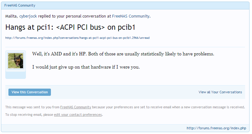

Malita
Apr 20, 2014
9
Oooook, I guess.
I'm just disappointed that the only advice giving was to "give up". Instead of giving actual "helpful" advice for someone trying to use your software, I'm being told to give up. Yea, FreeNas is free, but your reputation should be worth more than the advice I was giving (none) for my first time on the forum and a user of the system.

Well, if you read our stickies we already provide lots of info. Most of that info includes things like "AMD based boards aren't always compatible with FreeBSD" and "OEM hardware is very hit and miss". Nothing I told you isn't already in this forum in at least 100 different places already.
AMD doesn't spend much money on developers for FreeBSD support, so that's somewhat expected.
OEMs are usually selling stuff that is everything else *but* FreeBSD, so that's somewhat expected too.
This really shouldn't be too shocking for you at all if you've tried searching around the forums...
Even if you ignore both of those you have other limitations:
1. Realtek NIC: Not recommended around here in the slightest. Good chance it won't work with FreeNAS.
2. Onboard Audio: Not recommended around here in the slightest. More hardware that can cause the system to not work right.
3. Uses non-ECC RAM: Not recommended around here, but very much a personal choice/risk.
4. 16GB of RAM max: Eh.. not ideal but not necessarily terrible.
5. I can't even figure out what SATA chipset it is or isn't using, so I can't even tell you if any of your SATA ports will work or not.
Overall, even if it worked, it's not something we'd ever recommend anyway. So I don't consider it a big loss that the hardware decided for you that it won't work.
Around here, you pretty much buy the right stuff(and it works out of the box), or you buy/reuse whatever you have and you'll end up on an island stuck troubleshooting any/all problems on your own. I don't have your hardware so I can't really provide any troubleshooting assistance. I abhor AMD on FreeNAS. It's just not a good fit at all. Some people do it, but far more people get Intel to work than AMD.
That's all the logic that went through my head before I distilled it down to "I would just give up on that hardware if I were you". It wasn't a 5 second thing. I actually put a lot of thought into it.
