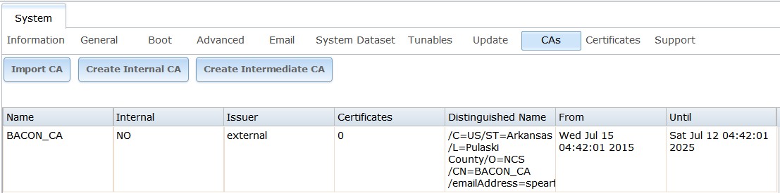

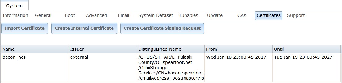

I use self-signed certificates on my FreeNAS 9.10.2-U1 servers... Did you load your CA certificate in System->CAs, using Import CA?
Here are screenshots of my certificate setup:
