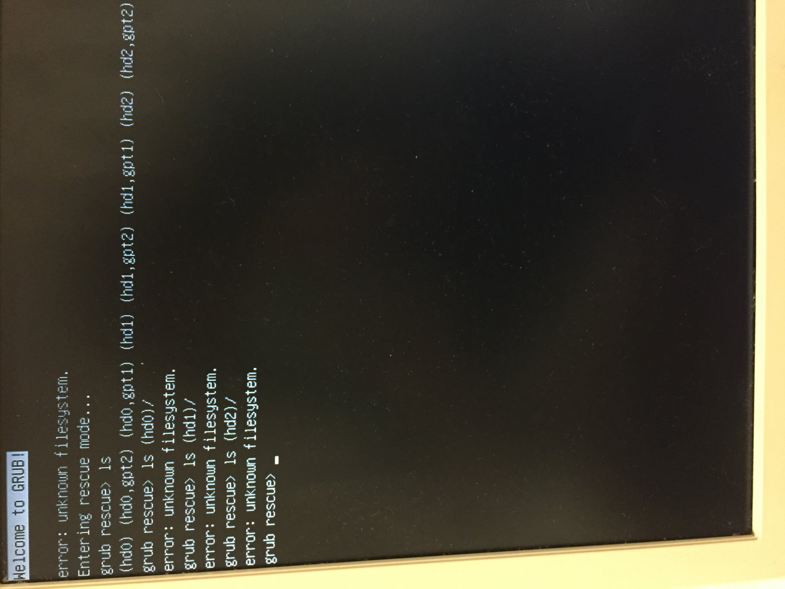

Hi so i made something really stupid and installed FreeNAS 11 on internal sata SSD
It worked fine for few days then after i did reboot from webGUI it just didn't posted
Now it displays
error: unknown filesystem.
entering rescue mode...
grub rescue>
I tried to locate GRUB files but it says error: unknown filesystem.
+ i have non-ECC ram so i was just asking for trouble :(
Is there something that i can do to make this system post again? i really don't want to lose my VM's and FreeNAS config

Please try re-installing, but select the 'upgrade' option. This should keep all your configuration in tact and repair the boot loader.
gegtor
Sep 16, 2017
99
Thanks
But i don't know what's is going on here it's working okay now magically
After like 20 reboots it's working again
Immm soooo lucky
I will use this chance to make backups then i will investigate
