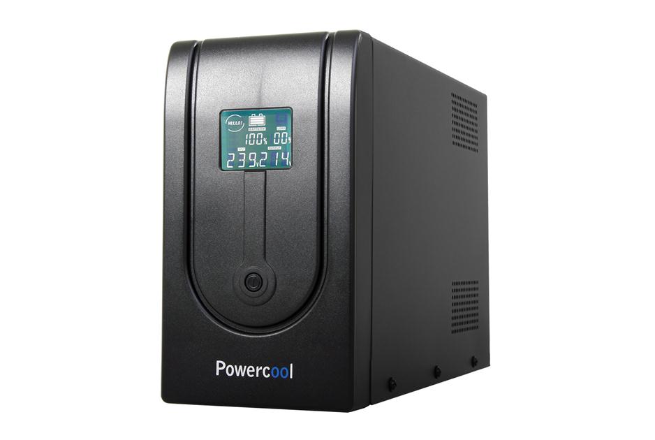

All now sorted ..but I didnt want to go through that again so bought a PowerCool 1500VA UPS ..
My problem now is how to connect it having never used one before.
Does Freenas 9.2 even support this UPS ..?
I have found the relevant section in the webgui ...but sadly PowerCool doesn't appear in the list.
Are there drivers I can add to give me support ?
Many thanks for reading this.
..and hopefully I can get some help on this issue.
I'm including a picture of the UPS
rgds
VS

Hi dlavigne
Sadly No ..
Unless the ups is sold under another name ..
Not in the list ..so can't select it.
So
..am I the only person to buy one of these ?
I did use the search box ..entering 'powercool' ...
no results ..
doh
Perhaps too new to be in the list ..
just my luck.
btw ..this unit is usb only ..
no serial connection to PC

You could connect the USB to another computer on the network and have FreeNAS monitor it remotely. FreeNAS would still get all the ups info and you would have two computers plugged into the ups.
..An option I'd considered already ..and might well do just that.
The only things that is putting me off are accessibility..and power consumption.
As the Freenas server is physically distant from any PC.
I guess Id have to run another pc 24/7 in close proximity to he NAS ...or at least a laptop.
Not an ideal or very 'green' setup but workable I guess.

As long as you can run NUT on the PC it's ok. So you can use a Raspberry Pi, very cheap and needs only a few watts ;)
