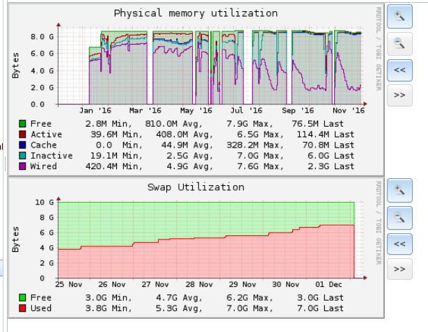

Screenshot from the reporting tab confirms the error: Seems something startet using more and more RAM over the weeks:
