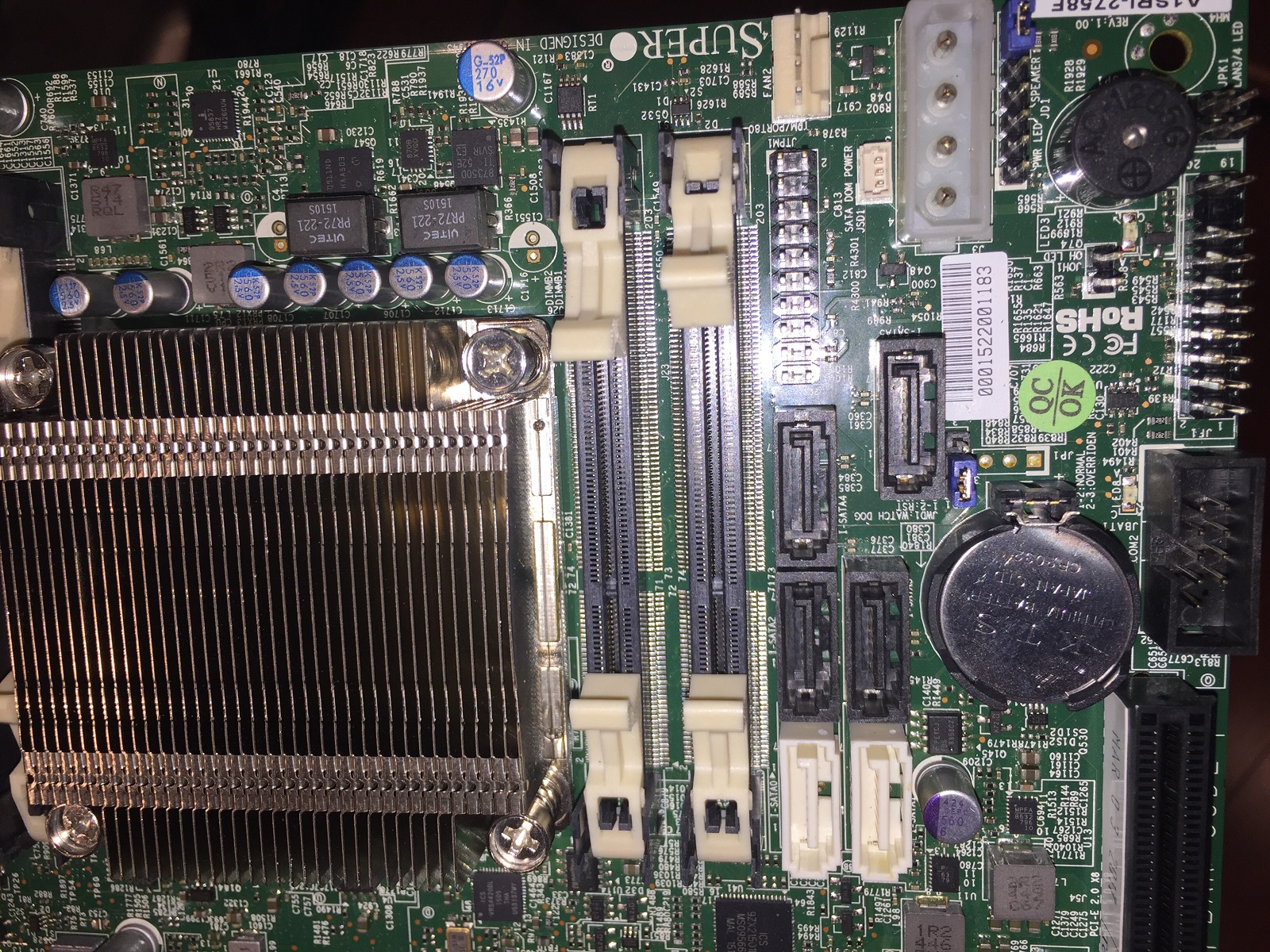

Other side.
-tm
Revision 1.00? They must be using fixed silicon, then.

Hi
I bought a Supermicro A1SRi-2758F board in the beginning of April, when I got the board I saw that it was revision 1.00.
Being a bit paranoid I'm wondering if this is a fixed board or not, is there any way to determine that?
I forgot to bring up this question with the store when I bought it, but I will also contact them and see what they say.
Hi
Ask Supermicro support, they'll be able to tell you. What's the manufacture date?
Scharbauer
Feb 4, 2017
7
That information isn't present anywhere as far as I can see. There's no date on the product box and I can't see anything on the board itself. Maybe it's on the board somewhere but I've missed it?
Edit: Ok, after booting and entering bios it became a bit clearer.
In bios:
Version: 1.1a
Build date: 08/27/2015
It seems most likely that this board is not fixed then?
Arwen
May 17, 2014
3,611
@Scharbauer
That likely is the BIOS firmware build date, not the system board's build date.
