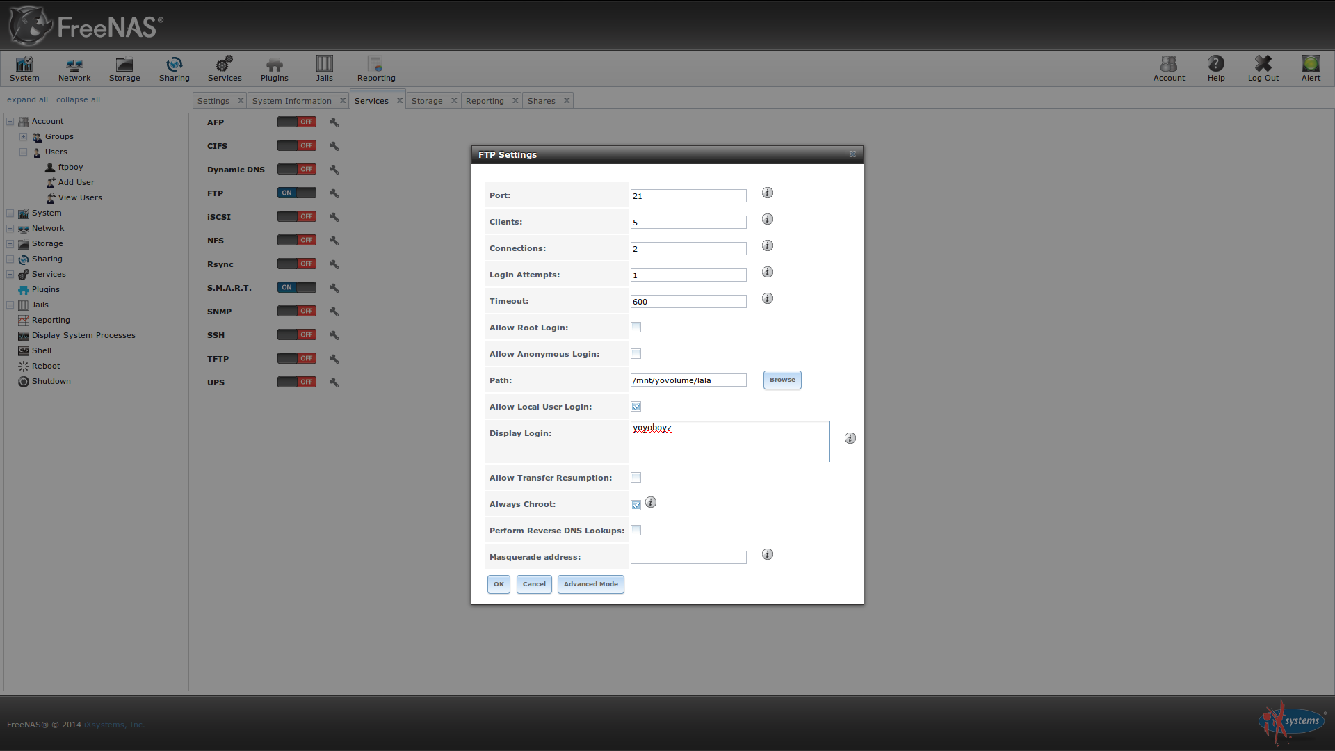

Hi all,
I am using the FileZilla client to test out FTP as a user. I can login anonymously, but when I change the settings and try to do it as a user, I get the following response:
Response:    550 SSL/TLS required on the control channel
Anyone know if I need to toggle more settings?

Whattteva
Mar 5, 2013
1,824
You have TLS checked but you're probably connecting without TLS on FileZilla, so the server rejects it.

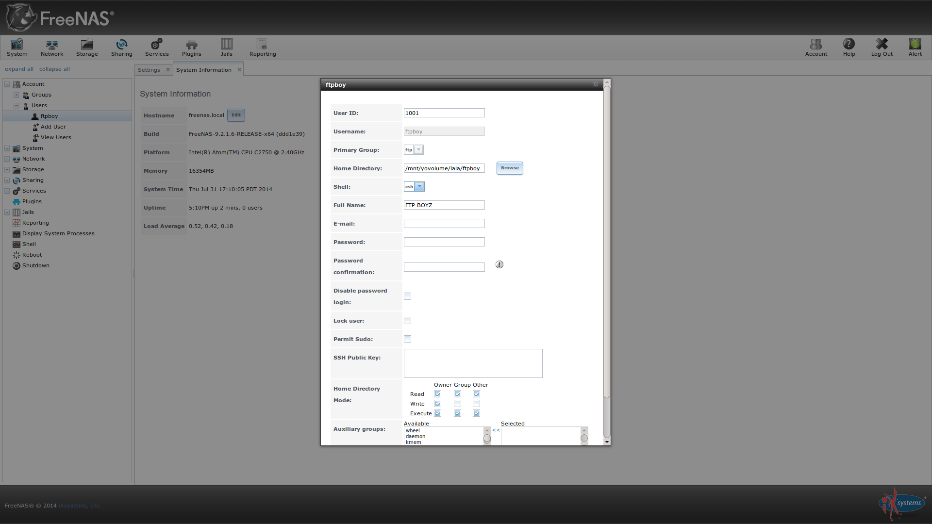

cpunlimited
Jan 23, 2014
6
I unchecked the "TLS" box and now its telling me it could not connect to the server.
Here's my user settings, anyone have an idea?:
cpunlimited
Jan 23, 2014
6
Nevermind, I got the problem solved. It had to do with chroot and home directory. Thanks for the help though!
