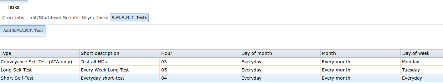

thx again for your comment! I checked the cables and indeed it was a bit loosy, so let's see if the problem is fixed or whether it occurs again in the near future. Another interesting thing is the fact you mentioned about smart-tests. Actually I was thinking to run them on a regular basis, because I configured it to do so. (See screenshot below) smart-services is enabled.
Could it be, that those test do not run correctly, because my disks are not recognized as /dev/ata[0-n] but as /dev/da[0-n] instead? (Just I guess into the wild)
Maybe someone has an idea or hint?

Stux
Jun 2, 2016
4,419
hi bestboy,
Thx and greetings
sebastian
You need to select disks to run the tests over in the edit dialog.
SebbaG
Oct 12, 2014
25
:) OMG, seems I have been tricked by the UI. :( oops, I thought when it listed the drives it will run those test on them, but it seems I was wrong. Just discovered the difference between blue and white highlighting (When you select them they become blue) :)
Thank you for this great hint!
Stux
Jun 2, 2016
4,419
And you also need to recheck the right disks are selected when you shuffle disks around...
