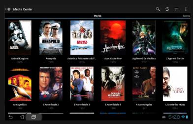

An alternative for video decoding and music player:
I use two silent fanless devices based on this chip with a simple CIFS share on a Gb network, and it rocks, even with Full HD 3D BR rip, and without any fastidious setup.
