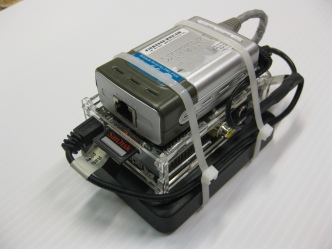

I've had a Raspberry Pi buried 3 feet underground in a PVC pipe with a 2TB drive served over iSCSI for 7 years and counting. It's all powered by POE. I'd do it the same way again for backup. Only trick is you have to recompile Raspbian kernel with iSCSI support.
