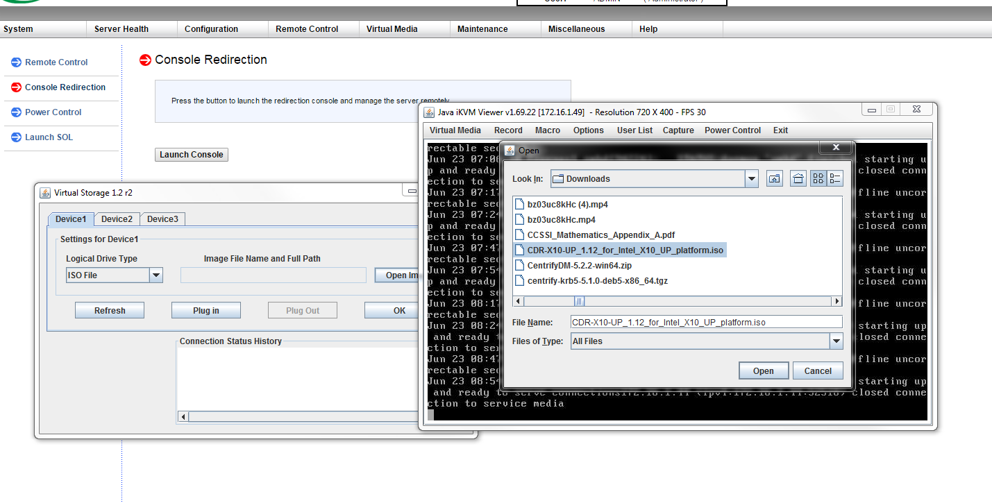

Try the virtual storage settings within the remote console:
Also, you can just use the snipping tool and copy the image and paste it directly into your post.
15,504
FWIW, when I use the remote console through IPMIView on my Mac, the virtual storage settings seem to expect a share, and I don't see a place where I can mount a local image as virtual storage. When I launch it from the IPMI web interface (which I've only been able to get to work under Windows), I get what @depasseg shows.
