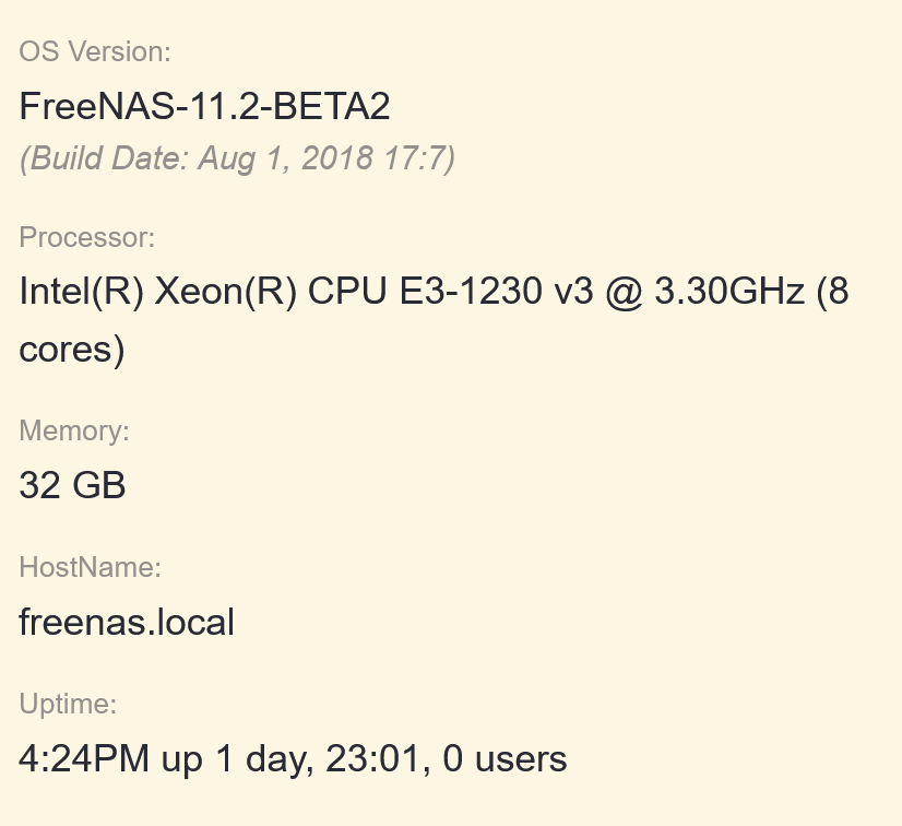

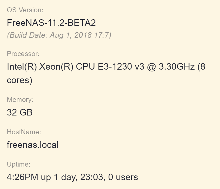

My server is running directly off the hardware - no vm:
When I access the server locally from my laptop everything works fine. But when I try to access from work, accessing the same laptop via Teamviewer 13 the logon window does not show up.
Do you need further details?

What version of windows are you running, what browser and version are you using, what version of team viewer are you using, have you tried the new UI and the old one?

I am running Windows 10 Pro/1803 (both sides). Have tried several browsers: Chrome, Firefox, Edge, IE - all at the latest release. Teamviewer release 13.2.5287.
I believe the old UI would work but how can I get the option to chose this? As said, the browser window shows only the splash screen with the big shark graphic in the middle
