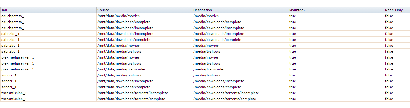

I am probably not too much help but I have installed sonarr(pretty much the same as sickrage) using the freenas plugin which creates another jail. Going back to your data question yes you have to link/map your storage. Think of a jail as a virtual environment or another machine. This is why some people simply install everything into one jail. When you install plugins it creates a jail for each plugin. So with that being said you will need to add storage to your jail. Here is a screenshot from mine.

thanks for info.... although i got farther this time still not quite there....
i know understand the jail concept. i am ok addding all to one jail/environment!
