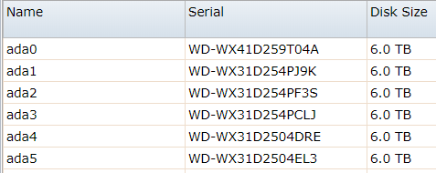

Finally my ZFS pool is upgraded !
One disk at a time, 6 days ! :)
