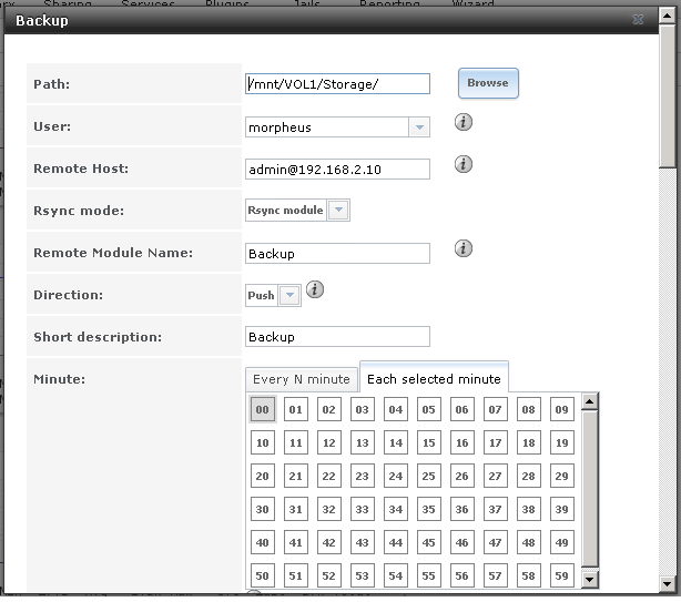

Hey
I'm doing an rsync task to a Synology nas which works in a similar manner, I also created a password file and added an rsync task to FreeNAS with the following option: ( at the end: Extra Options )
--password-file=/mnt/VOL1/rsync.pwd
You can also add this option to let it write a logfile
--log-file=/mnt/VOL1/rsynclog
See the screenshot for my first page of the task.

Thousandbuckle
Jul 9, 2014
136
What is the reasoning for adding "admin@192.168.2.10" in the Remote Host Field? I have not seen any information that says to add a user in this area. I see that your user "morpheus" is not the same as the Remote Host Field.
Morpheus187
Mar 11, 2016
61
admin is the user on the Synology as which has write access to the share. I think I tried it with another user but it didn't worked out. When you hover over the "i" button in the FreeNAS gui it actually says:
"IP Address or hostname. Specify user@hostname or user@ip-address if your remote machine user and above rsync task user are different."

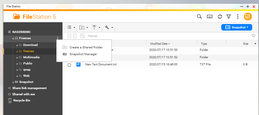

i've got the solutions for rsync from freenas to qnap :
QNAP site :
  1. Setup share folder in our QNAP that you want to rsync from your freenas
for ex : Freenas
2. setup your rsync server on your QNAP from menu “ Backup Station “ like below :
make sure that username and password that you’re using, same as with username in freenas that you will going to rsync
Freenas site :
  1. create account with username and password same as username password in QNAP ( look point 2 )
  2. set this account full access to the dataset that you want to rsync
  3. create new folder for store file for password that you will use for the username :
  • touch /mnt/Data/passwordlocationstore/rsync.pwd
  • just write only and only your password in that file ex : password
4. set the user account that you will use for rsync full access that folder “passwordlocationstore” .
5. create rsync task in freenas like below :
extra option is : where the password file located (point no.3)
6. End ( you can test run rsync to make sure it’s running )

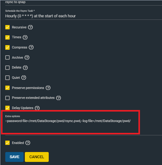

May 13, 2021
22
i have no clue about vi chown etc.
instead i used winscp to login as root (had to enable ssh for root user), then i browsed to a folder i created a home for my rsync user, then i created the pwd file, then added the password in it, then in rsync task added the extra command as advised. added the rsync module pointing to the sharename on the qnap
i'm assuming it's "share" without quotes, and not "/share/CACHEDEV2_DATA/share" ya?
it didn't work.
i created the rsync server on both truenas and qnap qts both match username and password credentials. added permission rights for both to their respective folders. but doesn't work.
FosCo
Sep 20, 2020
23
it didn't work.
What's the log telling you?
You probably could change permissions and owner with winscp, too. Switch user and group to your truenas uid/gid of the wrap user you created on truenas and which should run the job.
Change permissions of the file to read only by owner (one checkbox upper left corner of the 9 or 12 checkboxes).
And watch the log please.
