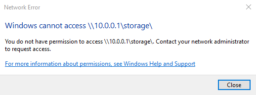

This has been ongoing for quite a while and it's incredibly annoying. Everything will be working fine for weeks, then for no apparent reason when I login over SMB like any other day it takes my credentials but instead of showing me the root share directory it shows me this:
Why? I can assure you I touched nothing in the WebUI or CLI because there's no reason for me to touch it if it's working. For no explainable reason it just quits.
Troubleshooting steps I've done that have yielded mixed results are:
Restart the server: Sometimes this fixes the error, sometimes not. As of late if it does fix it the fix doesn't last it errors again in a couple days.
Restart the SMB service: This worked once but hasn't worked since.
The only real "fix" that works for any extended period of time is deleting my user account and recreating it. This user owns the pool set to 700 permissions. So it's like the server takes the credentials because it knows them but it no longer recognizes my sessions as being part of that user so it won't let me in the pool.
On the other end in terms of access SSH/SFTP are completely unaffected. I can remote in with absolutely no trouble. It's just SMB.
Has anyone experienced this before? Any luck solving it?
I'm on FreeNAS 11.1-U6

Need a context. What client are you using when this happens? Have you tried from a different client? Did you make any network changes around the time you first noticed the issue? What is your FreeNAS hardware?
Windows. 10 specifically.
Not via SMB no.
Motherboard: ASRock EP2C602-4L/D16
CPUs: Intel Xeon E5-2670's
RAM: 16x8GB ECC UDIMM from Kingston
HBAs: 3x LSI 9207-8i
NIC: Broadcom BCM57810S
SSDs: 12x 960GB Intel DC S4500
HDDs: 8x WD gold 2TB
I can verify no. I've actually done a clean install a few months ago due to unrelated issues. So unless Auxiliary Parameters have anything to do with it or SMB3 multichannel, or a 9000 mtu then I can't say anything else is the cause.

Well as the network stands right now it goes Server 10Gbit SFP+ NIC > 10Gbit switch > SFP+ 10Gbit client. I was previously doing P2P which I could test again. I am open to the idea of the issue being client side driver related as I haven't actually sourced a driver for my NIC. Just using whatever was pre-included with windows. It's not a normal NIC though so I didn't find W10 drivers.
That sounds very wrong. You should explain what you're doing there, exactly.
I'm the servers only user. I setup the pool owner as myself then configured the SMB service to have the guest account be myself. So locally only my credentials will get you into the share. Then any other service or account can't access it unless I give express permission to. That's the logic behind that.
Then there's this other issue that the users (just me really) are in the pool and I cant set permissions outside of 700 (like the usual 744) because when done so recursively it edits the permissions on the users .ssh file which unless set to 700 bricks public/private key authentication. I tried going in logged in as the user and editing that specific file with chmod and even though it takes effect attempts to authenticate continue to fail. So that's another reason permissions are 700.
I'm not saying it's impossible to make that work, but it's an expressway to permissions hell, with all sorts of things breaking.
In other words, you told Samba that unauthenticated users will use your user account.
I could spend some time trying to figure out what exactly went wrong here, but it seems wasteful. I don't understand why you opted for a rather convoluted permissions setup, but the correct way of doing things is:
  1. Do not touch the top-level dataset or the system dataset.
  2. Set ownership of datasets to be shared (and only those) according to who will be in charge of them.
  3. Set the permissions type (aclmode) on datasets to be shared via SMB to Windows (restricted).
