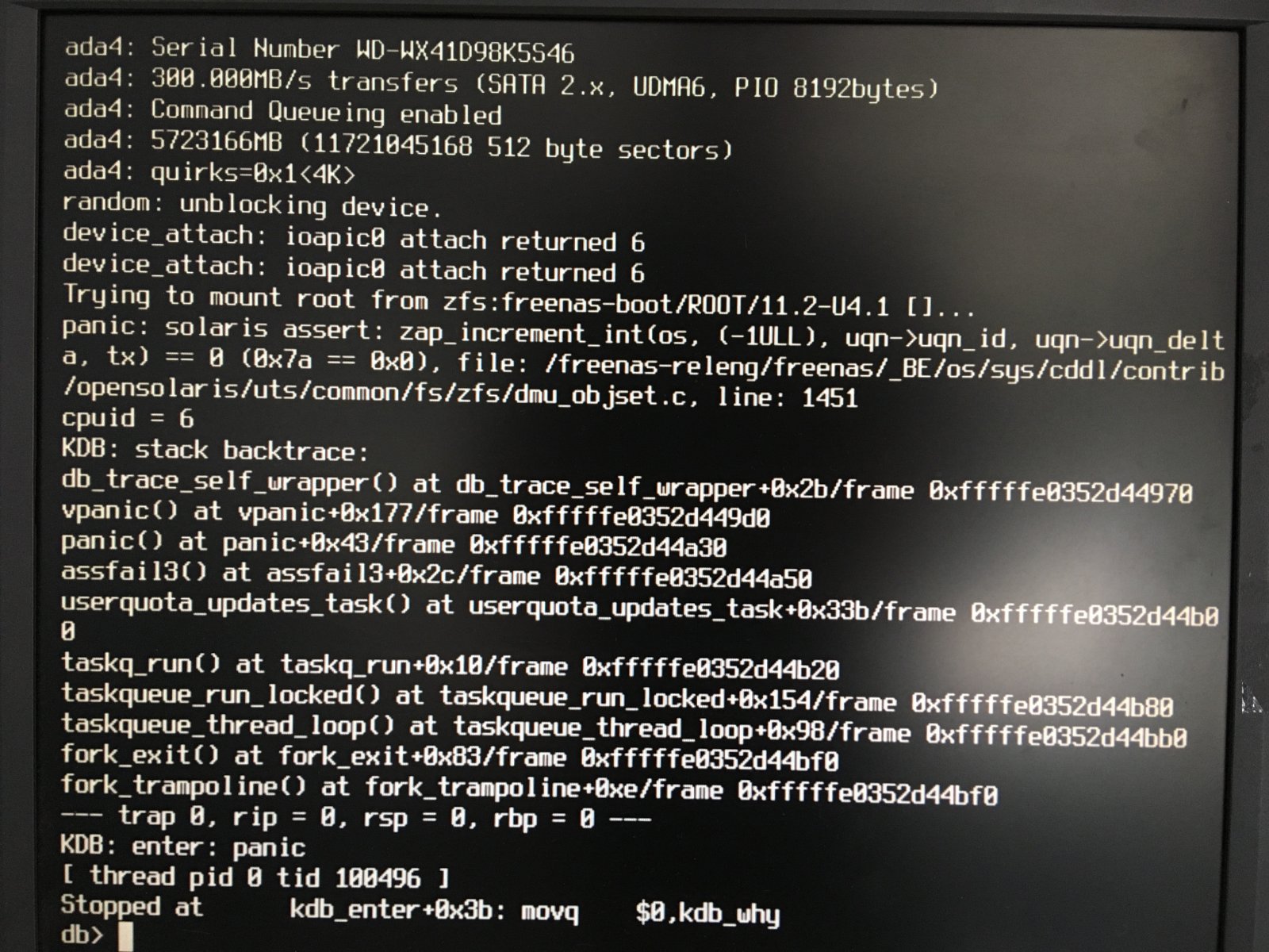

Hello today I found the freenas that was rebooted and showed this screen attached.
What is it? How do I solve it?

Most likely your boot disk died. Reinstall the same version to a new USB stick and restore your config.

I also believe it ... does not make me install or update the system :(

USB sticks have a habit of failing. If you must use USB, use a boot mirror. However, a SATA DOM or small SSD are more reliable boot device choices, and cost about the same as a USB stick.

I had an ssd disk. to be honest, for some time the smart status had detected some errors but I ignored them... :D

OK: I replaced the disk and reconfigured everything. Thankfully the pools were intact.
Thanks for your help!

There are several threads in this forum about taking a daily automated configuration backup. That can be very helpful in this kind of case, so you don't have to "reconfigure everything".

to be honest the backup of the config I had done ... but maybe I had done it on the boot disk (i'm a genius...) :D
