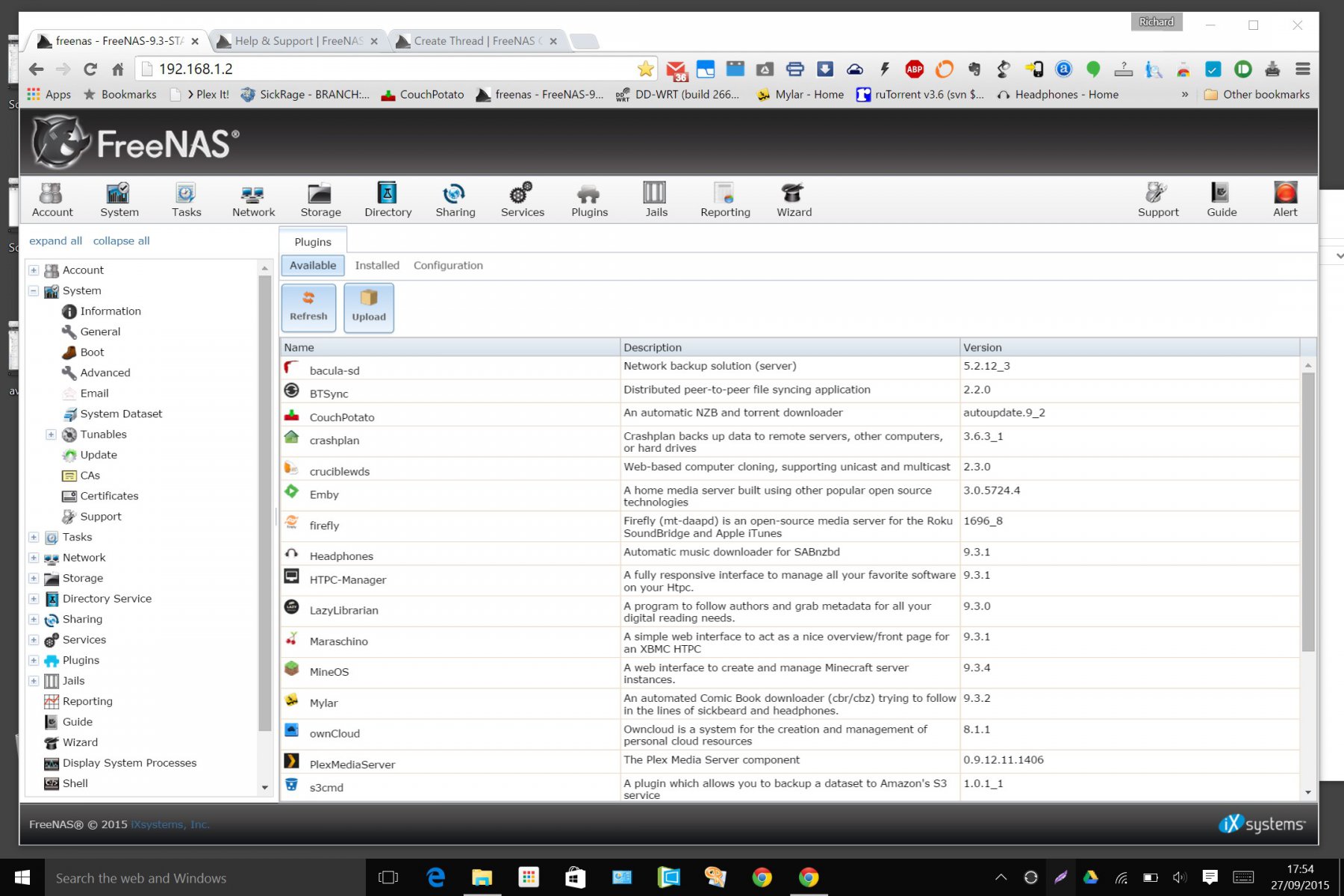

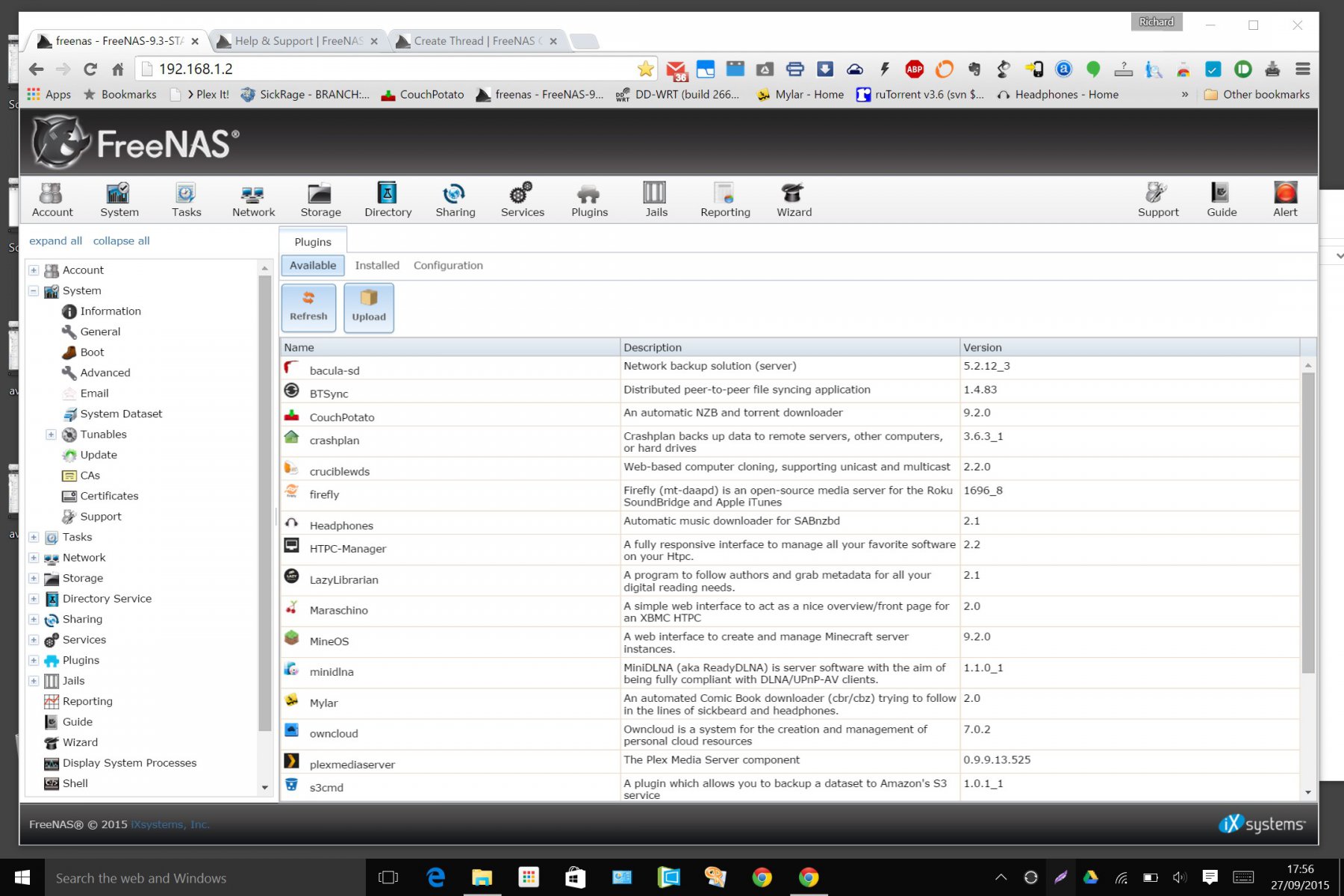

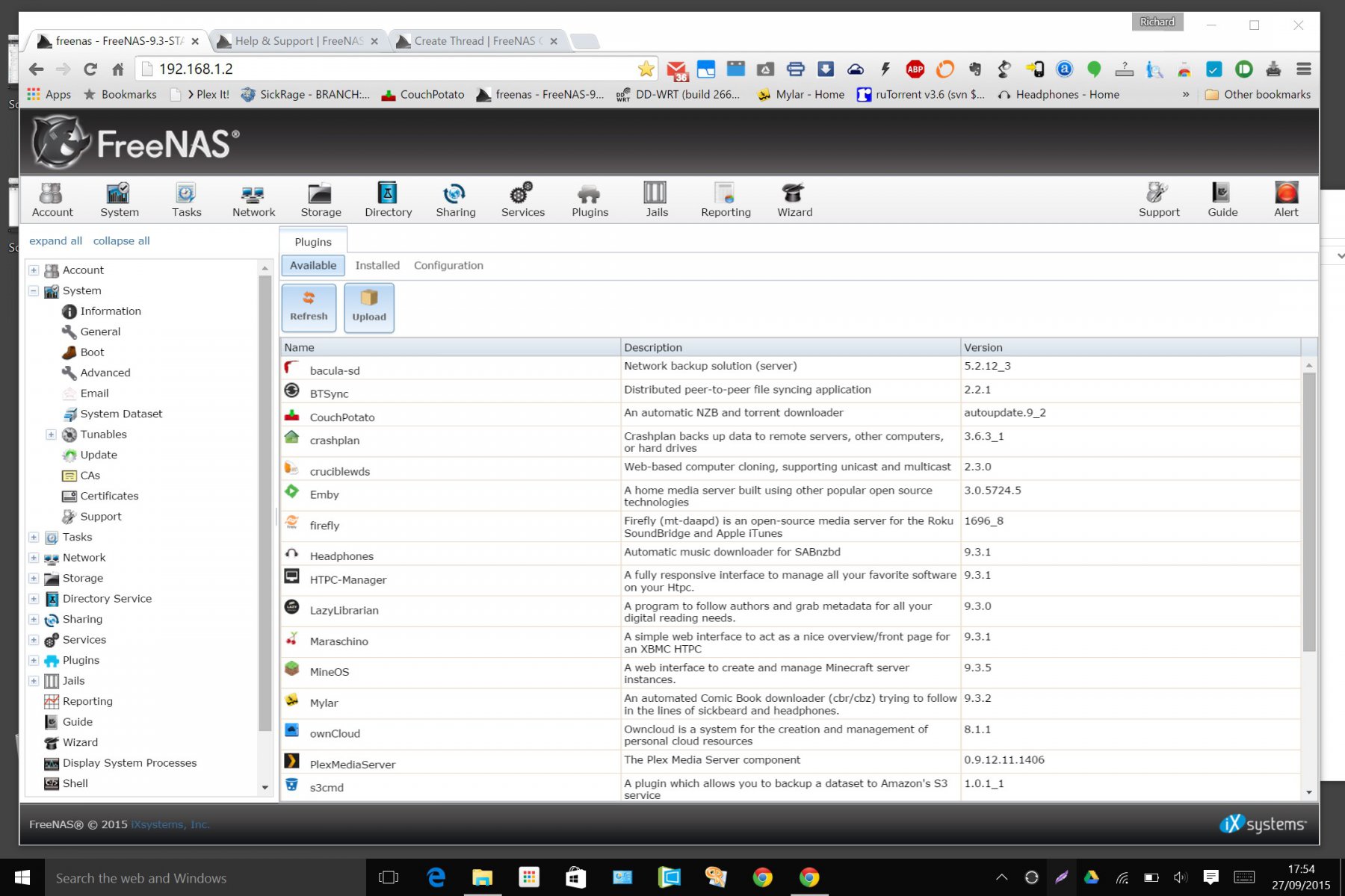

Afternoon all,
after doing the latest update to Freenas 9.3 stable branch, my plugins seem to have gone haywire!
Initially all my plugins looked like they needed updating, which I did.I then noticed some of them couldn't be restarted, despite restarting the jails. On closer inspection it appears the updates weren't updates at all and were in fact rolling back to earlier versions, which in the case of BTSync and Plex seems to have broken them!
An example of this weird phenomenon can be seen if I go to the plugins/available tab and repeatedly click refresh. The version of BTSync stated as available will randomly cycle between version 1.4, version 2.2 and version 2.21

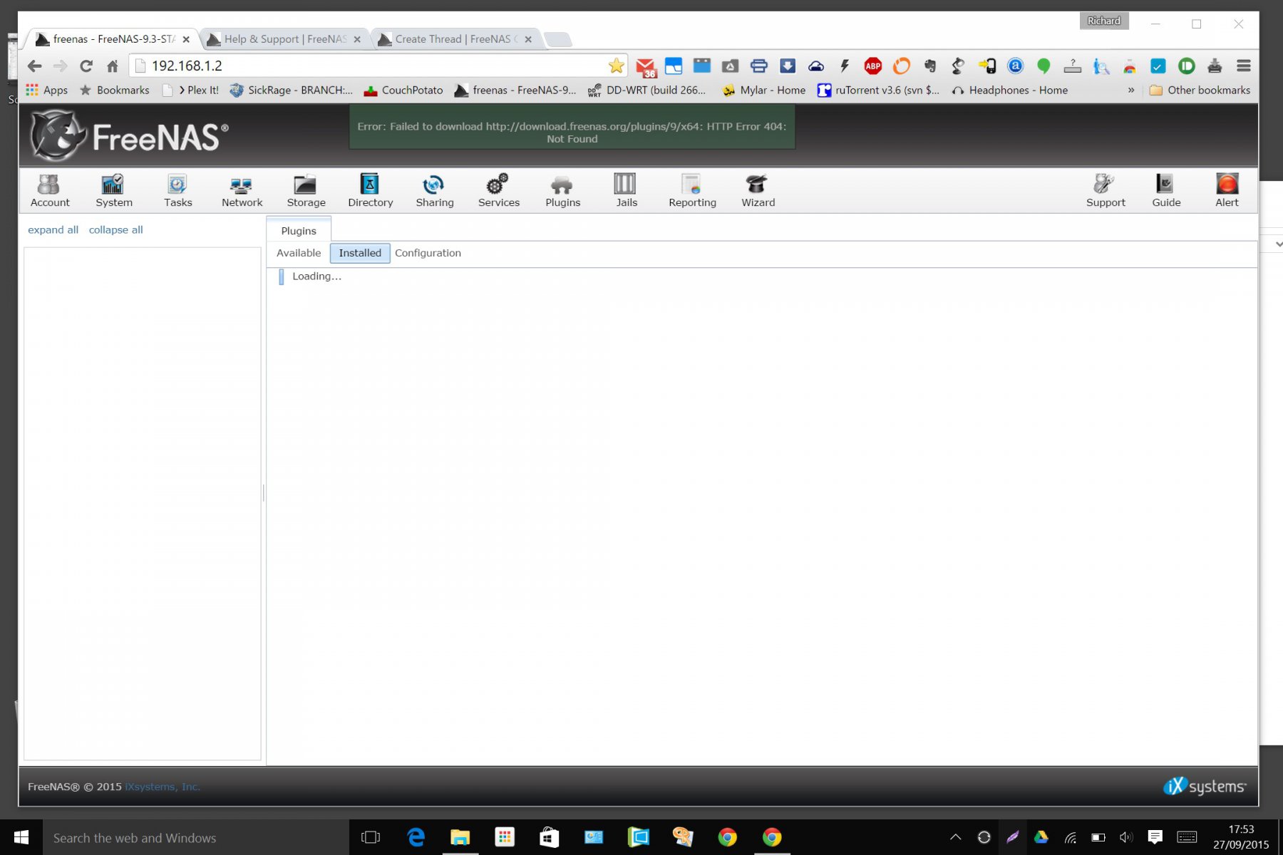

Does anyone have a clue what's going on here? My biggest concern is getting my Plex server up and running again? Is there a simple way of backing up the settings and configuration files of Plex, so that I can at least install it again, as I am getting a 404 error every time I try to update it to the correct version again (as seen in attached screen shot)

probably do to some hiccups in the CDN network. I would suggest no one do any plugin upgrades until this get resolved

The way I got around this was to reinstall Plex via the gui and then copy the Plex data from the old install over to the new install and I was up and running again in about 10 minutes

I either get a "Error: umount ... not a file system root directory" or "can not find template" error when trying to install a fresh plugin or create a new jail. Im unfortunately still stuck on the bad mirror as it is still trying to install old plugin versions and old freenas system version (when creating a new default jail). So, I'm still playing the waiting game
CraftyClown
Apr 5, 2014
214
I just pressed refresh a few times on the available plugins tab, until it switches to one of the good mirrors and I can download the latest plugin.
