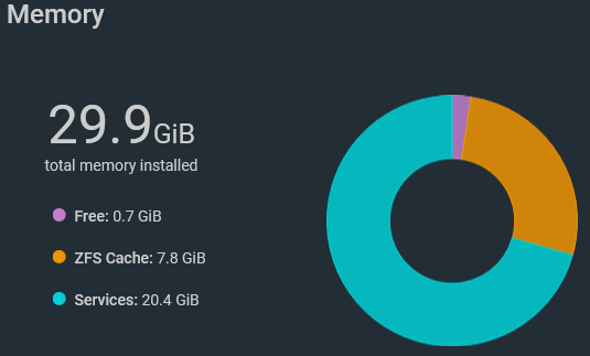

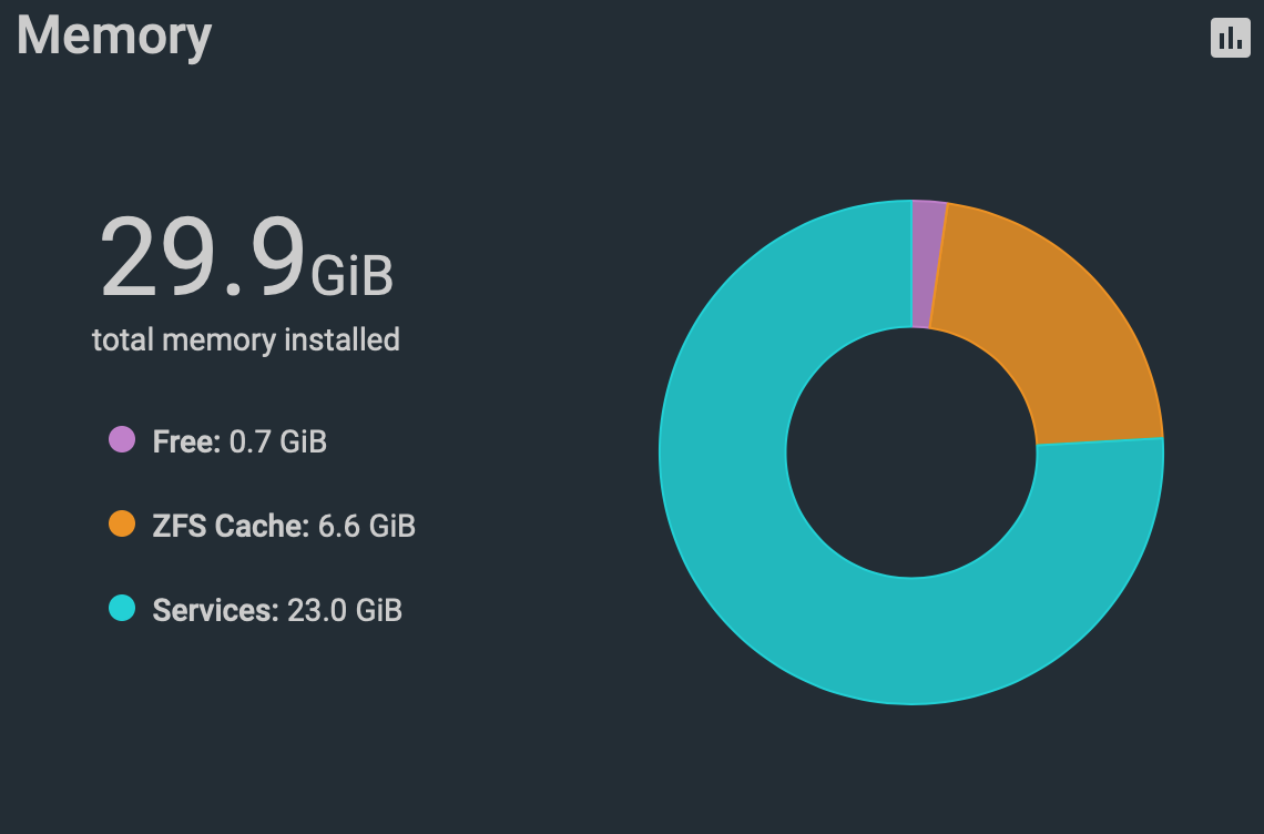

Hi there,
i have some problem with my freenas server. iam running 32 gb of ram, but the zfs cache is using nearly nothing of it. And as far i could read online it should be the other way.
i run on the same server 2 plugins (syncthing and emby) and 2 vms with (1 x 2gb ram and 1 x 4 gb ram)
and the amount of ram is weired. Any ideas here ?

ZFS Cache fills overtime as you use the system. How recently did you reboot? Is the usage slowly growing over time as you access files?

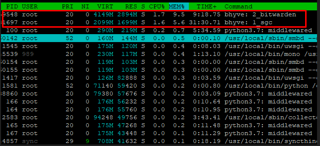

What revision of FreeNAS are you running? There were some revisions that had memory leaks in certain middleware components, so upgrading to the latest 11.3-U5 would be prudent if you aren't on there now.
You're also running 6GB of VMs and two plugins - I can see syncthing presently using less than 1GB, but that might change under activity - and how much is Emby using? This is memory that won't be available for ARC use.
The system is swapping to disk (482MB used) so that means you've got memory pressure somewhere.

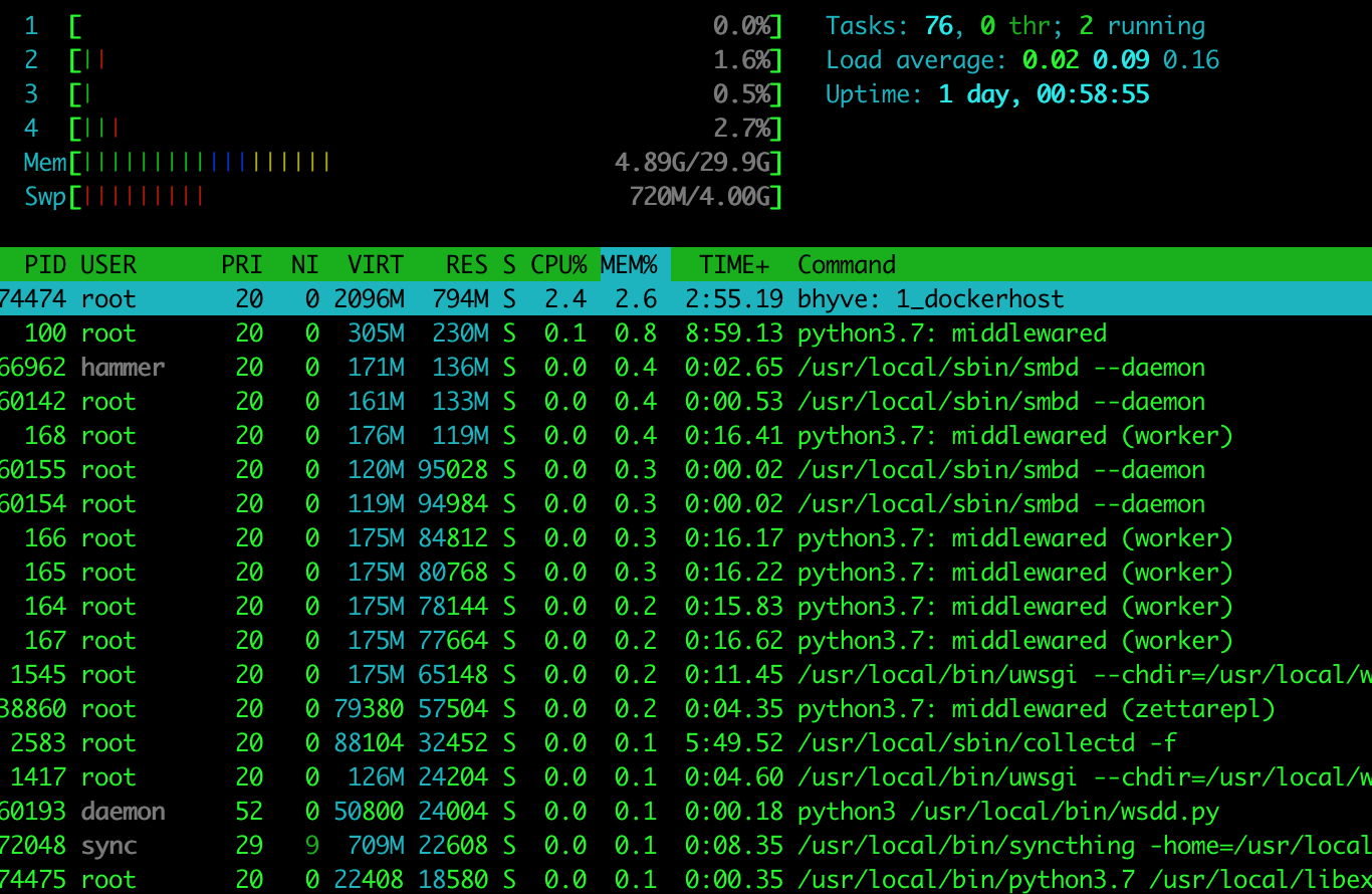

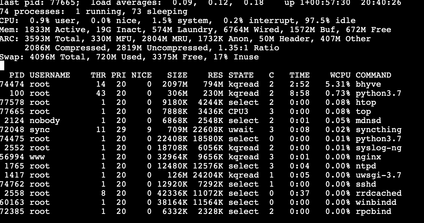

yeah tam already at the latest version 11.3-U5. and now only a vm for container are running. Emby ist just running doing nothing. Syncthing is just running after creating the plugin so no syncs configured yet. Emby unconfigured aswell.
nothing else is running..

You've got a relatively huge amount of memory in the "inactive" state (19G) which isn't being cleaned up by the laundry queue.
It looks like your Services and even your Swap amounts have increased between initial and second post - which makes little sense since you stopped the 4G VM and it almost looks like whatever other process gobbled it up.
Do you have this FreeNAS machine mounting other servers/exports as a client? Trying to think if it's somehow trying to cache a different filesystem as a client.
If you try stopping your plugins and the other VMs, and check top over time to see if your INACT memory memory starts to drop (it will go through "laundry") if it's dirty memory, and then get cleaned - this might help. But based on the trends here I feel like you might be headed for a reboot.
