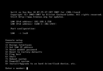

This is the screen shot i see

If that's the screenshot you're seeing, you're posting in the wrong forums. That's version .7, sorry I assumed you were using version 8.x since that is the version this forum is for, guess I should I verified. Please go to the .7 forums, the link is at the top of this page in the titlebar...

No my bad. It is FreeNAS 8, that pic was just something I grabbed off the web to give a general idea of what it looks like. Definitely Ver 8
