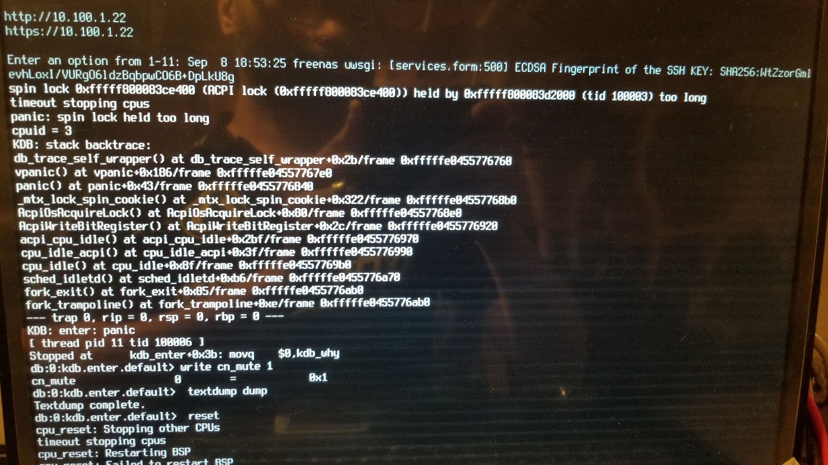

It seems to hang, I am not sure if it is a panic, as I cannot see the start of the crash, I will try and grab a screenshot from the next occurrence before I reset it.

That is correct, neither of these respond, using CTRL+ATL+DEL on the freenas also does not give a response, of terminating, it shows a dump and freezes
Edit:
Managed to get a screenshot of the error as it occurred on the freenas. and logs from /data/crash

ACPI lock? Sounds like we need to know your hardware. Also, start examining system firmware updates.
