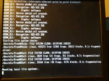

Removed a jail from the GUI, restarted, and now I am getting Mounting local file systems:. and that is far as it goes. I see a way to escape to loader prompt before that. I have been messing with this for a week. It has stayed on this screen for days and never goes any further. Restarted the other day and still wont' go any further. I am scared I have lost all of my data. Any help is appreciated! If i could somehow repair from the loader prompt or another way that would be great.

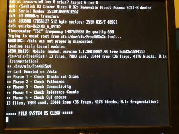

Can you post a picture of the hung screen? It may be that the USB stick died (if so, these will be UFS messages) and an easy fix is to burn another stick to boot from.

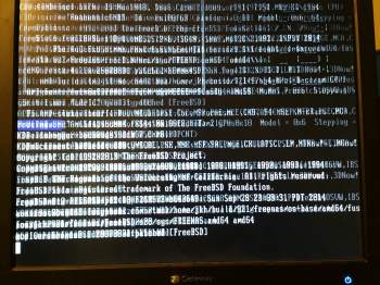

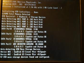

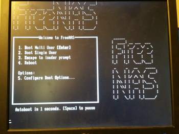

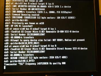

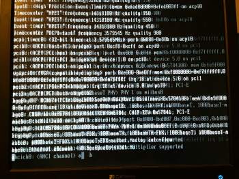

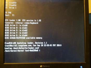

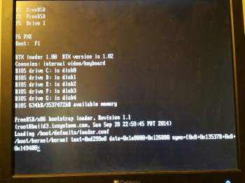

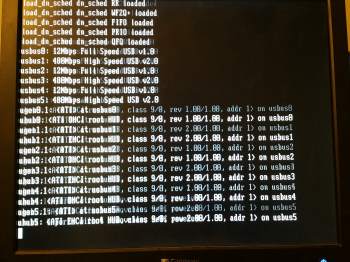

Absolutely! Here are some screenshots of bootup. Thanks again!

Try burning another stick and let us know if that fixes it.

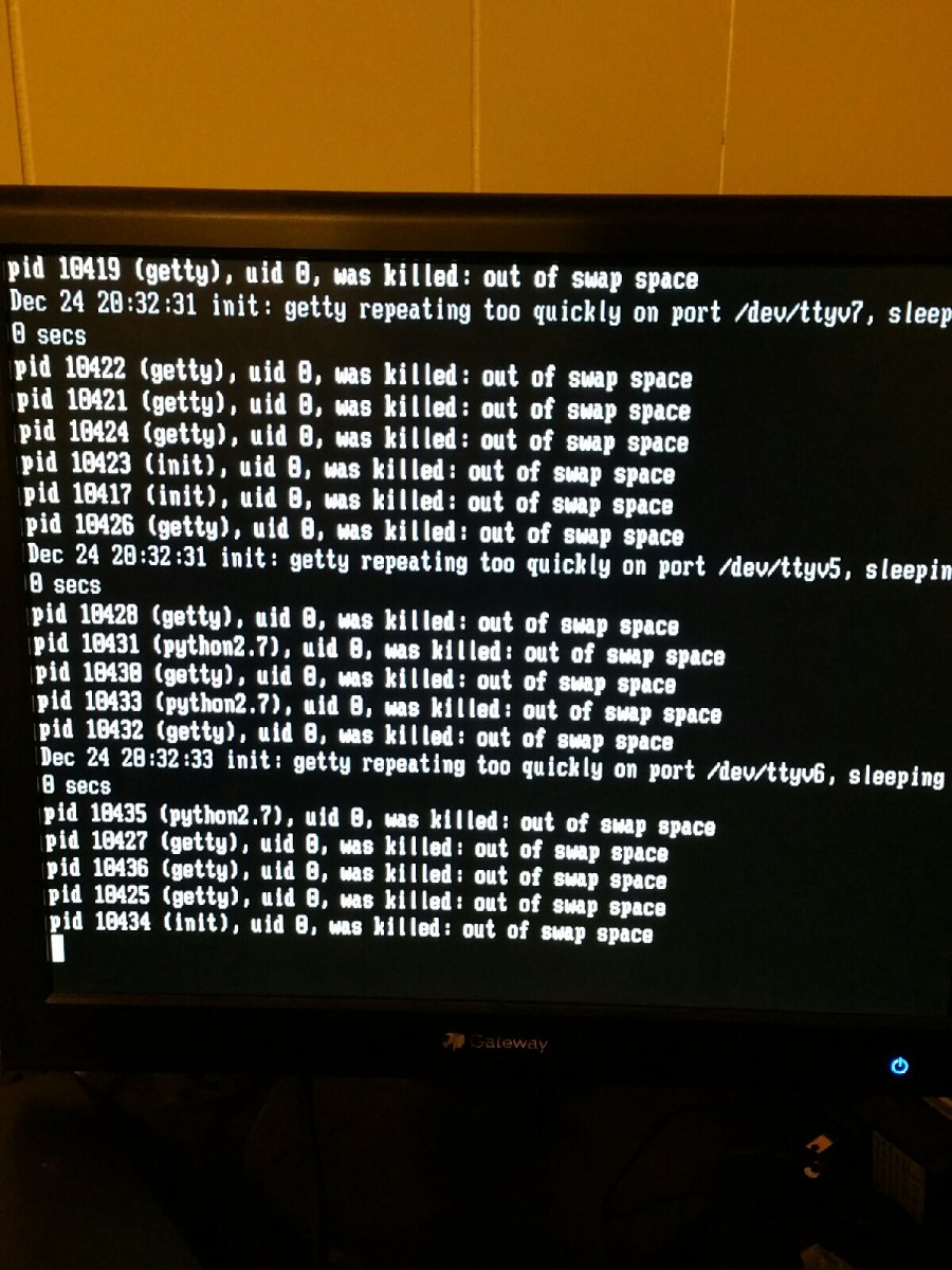

After reading what you posted above...I was able to fresh install Freenas 9.3 to a different usb stick and boot into the new gui. I went to volumes and attempted to import the volume and the message below is what I got. This resulted in the freenas becoming unresponsive and I had to do a cold restart. When the freenas came back up, I am presented with the very same message I got the first time...Mounting local file systems. See attached please.
My last backup config I have is a config from Freenas 8.3. I just upgraded to 9.* a few months ago.

Still can't import my zpool. I get the message above when I try "out of swap space". I have been trying a 8gb usb flash but space on the flash drive is probably not the problem. Here are some outputs that might can help someone help me. Thanks!

15,504
@frozn00, your system is complaining that it's out of swap space, which usually means not enough memory. What are your hardware specs? Motherboard, CPU, amount and type of RAM?

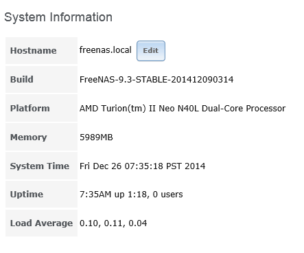

Something weird is going on. Please create a bug report at bugs.freenas.org and post the issue number here. The only other time I've seen the swap error was https://bugs.freenas.org/issues/5088, but that seems to be unrelated.
Thanks guys a lot. Here are my system specs. I am trying "zpool import -f RAID" right now to see if that will work. When using the GUI to import, it produces the "out of swap space" message and renders the system useless. It is not until i start from scratch with my usb am I able to get back into the system at all. Loses all network connectivity when it is at the "out of swap space" screen. Here is the screenshot.. Thanks again!

you are only using 6GB of memory and the min in 8GB. I'm not saying this is your issues but it is almost impossible to rule anything out until you get your system up to the minimum spec.
