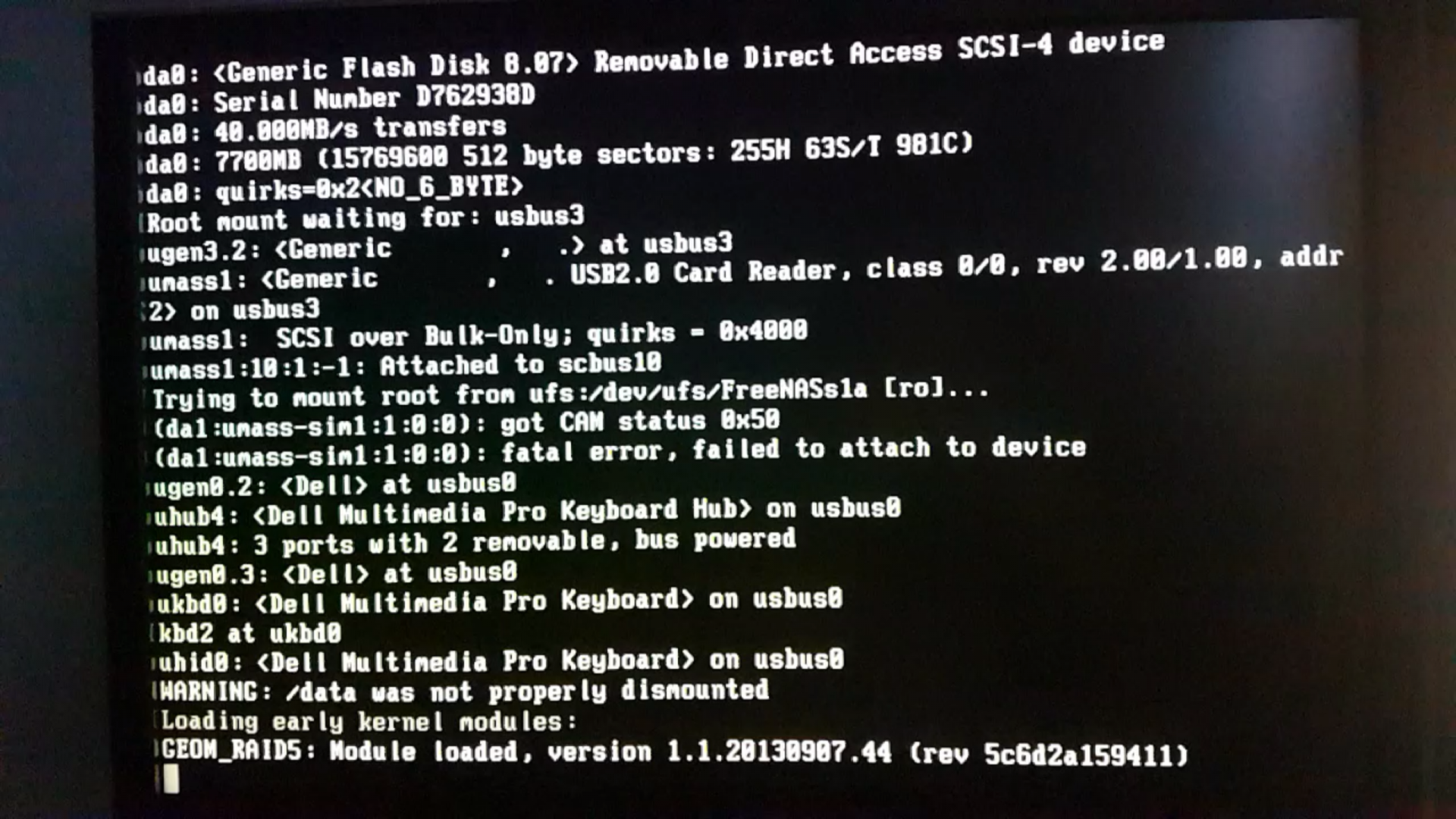

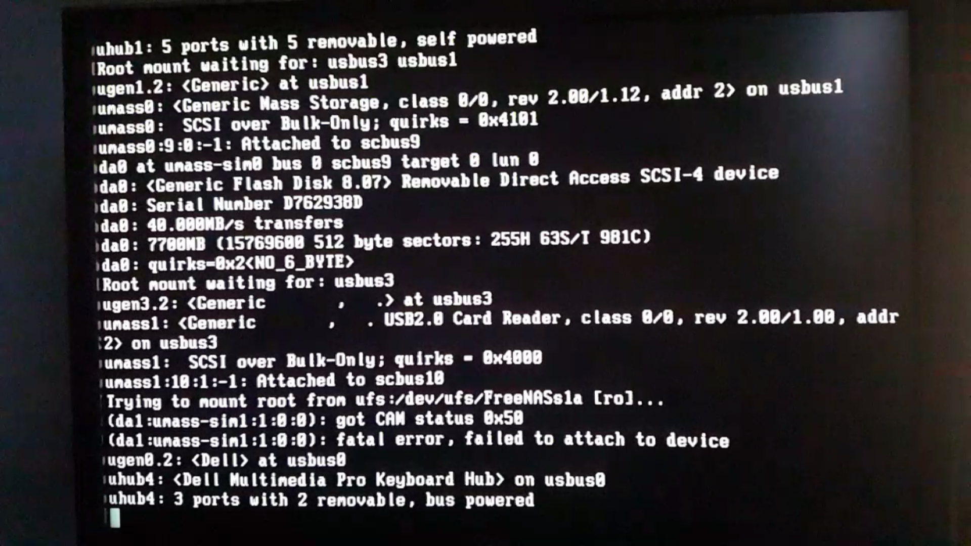

Yesterday I tried to copy some files from my computer to FreeNas, and for a reason that I don't know the file transfert went really slow. I just though "okay let's reboot". Bad idea: the system is stuck here : "Mounting local file systems:" and nothing more happens.
I have recorded with my phone the boot sequence as I don't know how to get access on logs at this stage which can be seen on the attached pictures (I'm not really confortable with unix world and FreeNas now, but trying to improve this..), and have seen the following error messages:
Trying to mount root from ufs:/dev/ufs/FreeNASs1a [ro]...
(da1:umass-sim1:1:0:0): got CAM status 0x50
(da1:umass-sim1:1:0:0): fatal error, failed to attach to device

WARNING: /data was not properly dismounted

Looks like the stick died and you're running an old version of FreeNAS. Burn a new stick with the same version (archived versions are at http://download.freenas.org/). If you didn't save a copy of your config, you will have to recreate all of your configurations. However, the data on the storage drives is still there as it's separate from the OS and config.

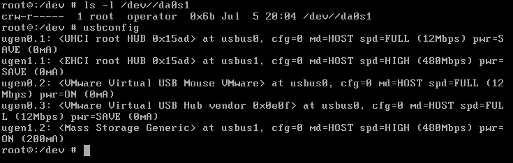

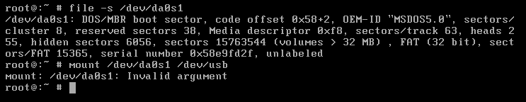

I have created a VM, I'm now trying to mound the USB stick, but for some reasons it is not mounting. Any idea what I'm doing wrong?

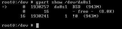

FreeBSD, when I run the freebsd-version I got 10.3-release.
I have attached some captures. I have tried to mount using different commands but without success... is there a special command for mounting it ? mount /dev/da0s1 /mnt does not seem to work or I don't use it correctly.

Robert Trevellyan
Pony Wrangler
May 16, 2014
3,778
OK, let's back up here. What version of FreeNAS were you running?
This suggests an old release (UFS boot filesystem), which means no backup of the database in /data, as far as I know. Sorry for the confusion.

Versions before 9.3 used UFS for the boot device filesystem. Forget everything I said about zpool import :rolleyes:
I think the process for mounting a UFS filesystem is basically:
  1. Create a directory as the destination for the mount, using mkdir <directoryname>.
  2. mount -t ufs <filesystem> <directoryname>
However, I don't know whether this will enable you to recover your configuration.

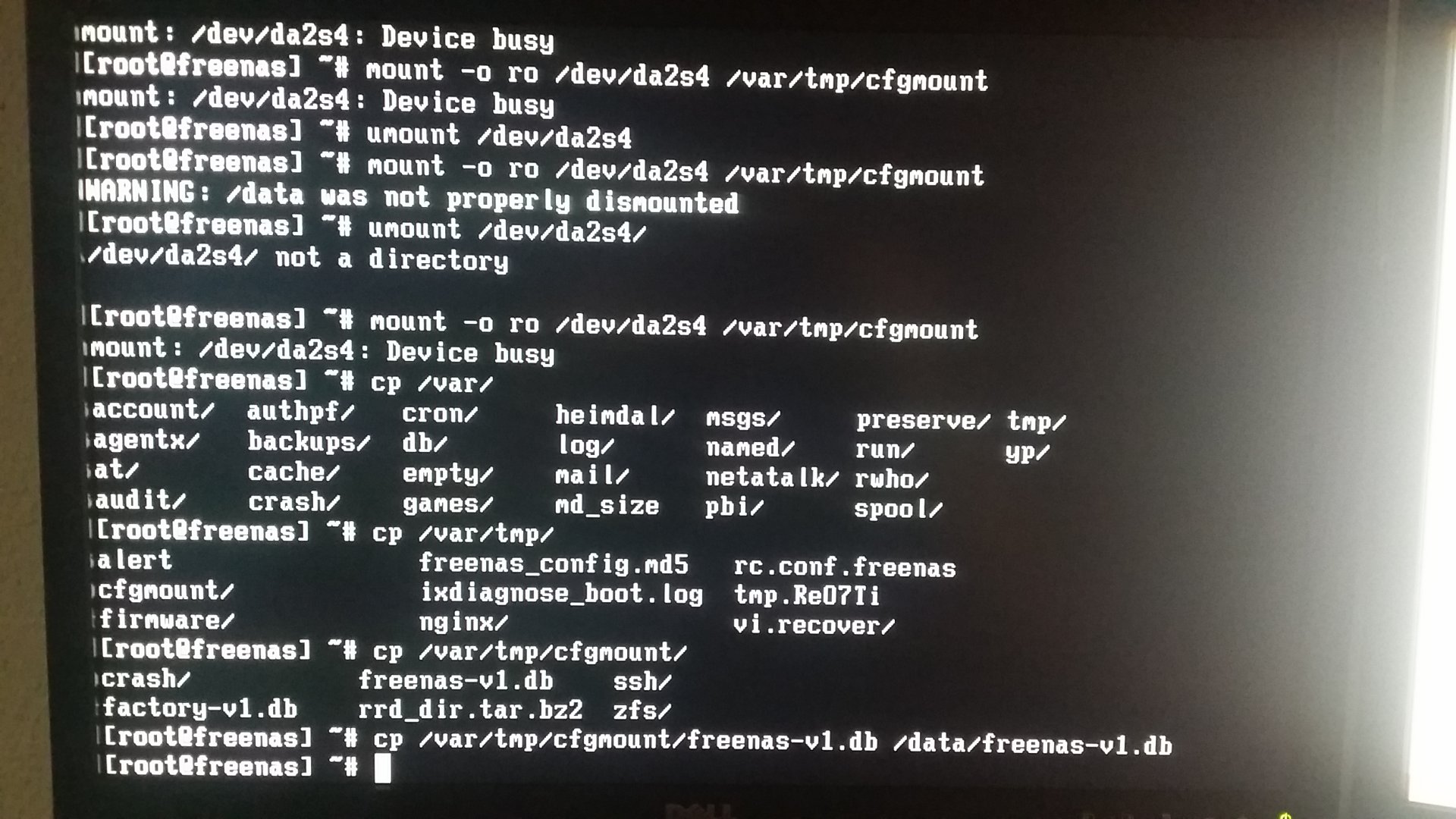

Ok, I was able to recover the configuration file but still facing some errors.
What I did is to install on a fresh new USB key the same version of FreeNAS (I have taken the 9.2.1 (there are 9.2.1.x versions, I have just taken the 9.2.1), when booted I went for the Shell, mounting the old USB, and coping the config file in the new USB. Shutdown, remove the old USB key, and power up.

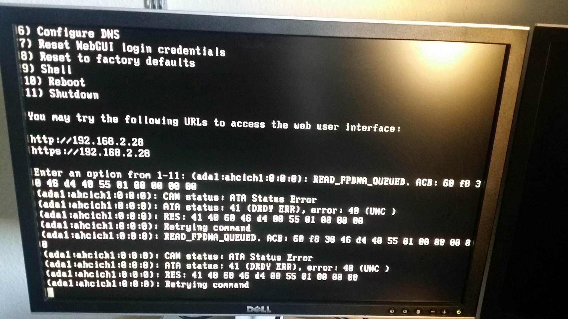

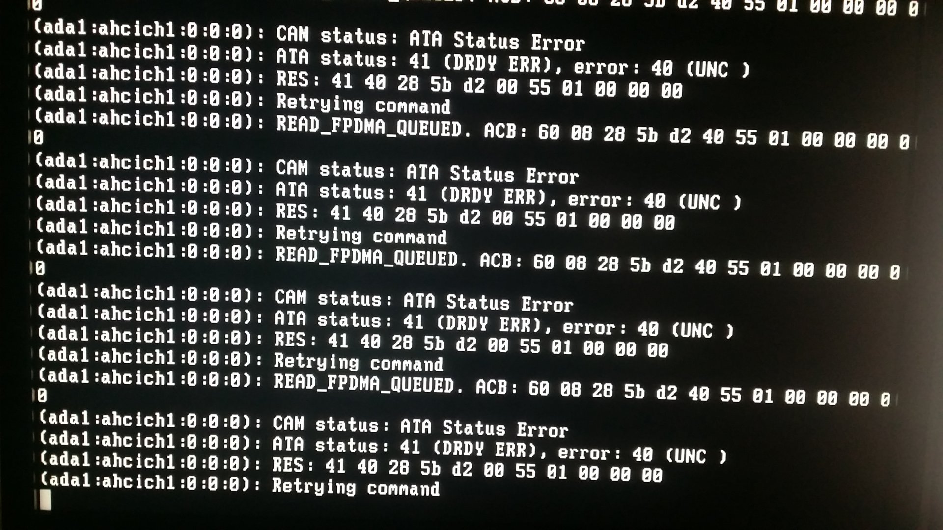

Second error is an ATA error, which I don't know if it comes from a HDD or not (see file "ata error.jpg"). Any idea where this error comes from? The server boot but keep having this error (see file "ata error after boot.jpg") until a certain point and then the error message does not show anymore.

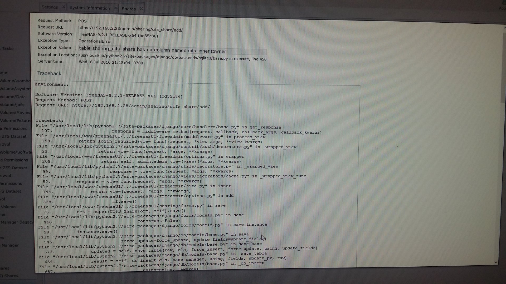

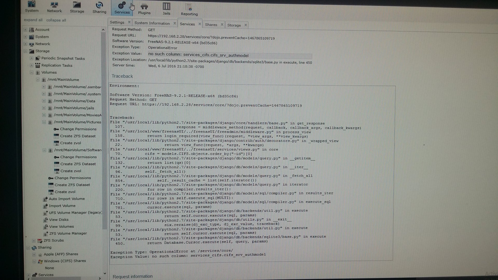

Third error is on the GUI: when I try to add the shares in the Services/CIFS, looks like some files are missing, see "cifs services error.jpg". I do have the same error for the Shares feature (see "share error.jpg").

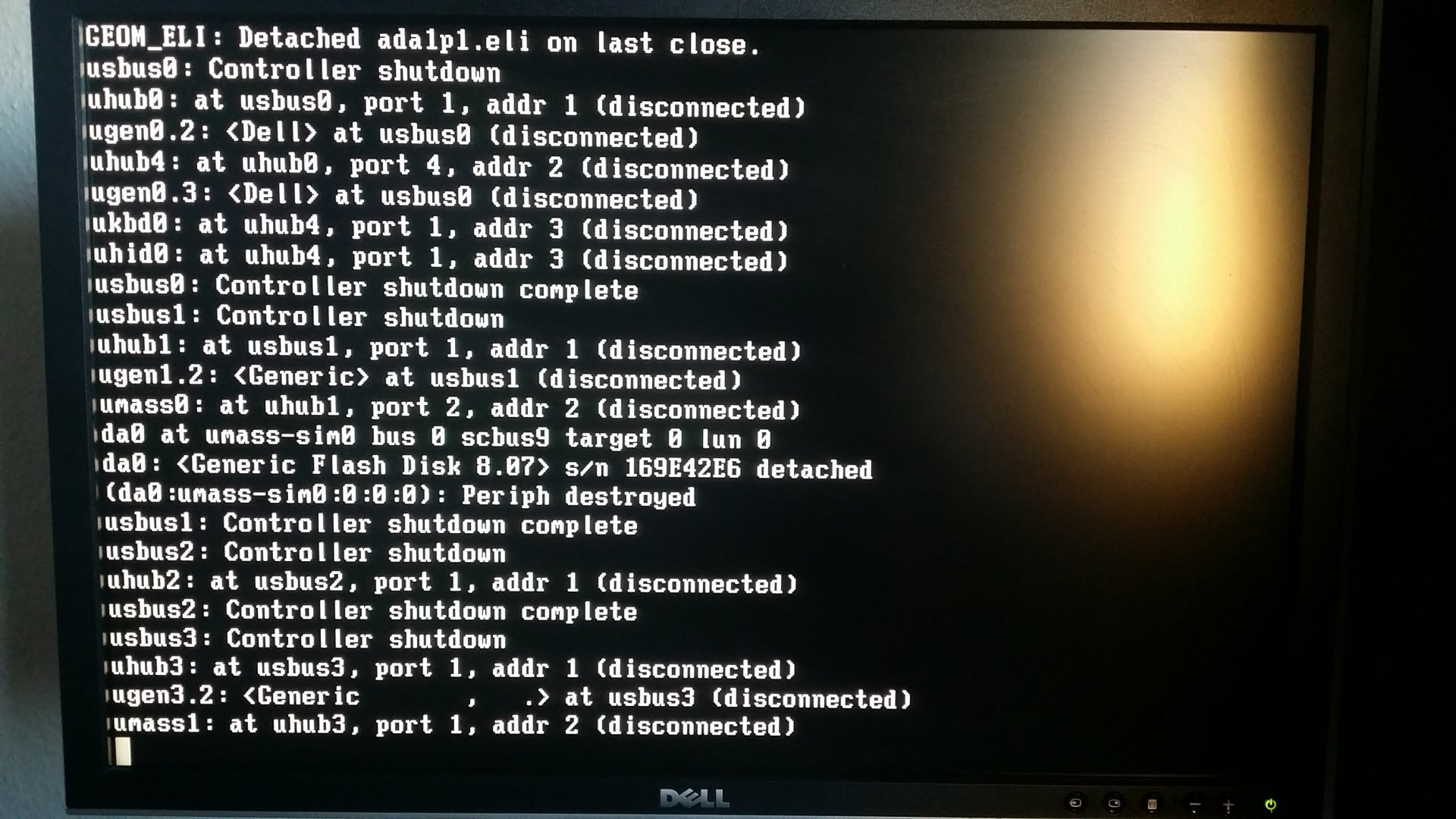

Fourth error is when I shutdown the server, it is blocked after having disconnected all USB controllers (see "shutdown stuck.jpg"). I don't think this is normal as I do have to press the shutdown button to force it.

Can this may happen if the FreeNAS version is not exactly the same (I doubt for the ATA and DNS errors, but maybe for the other GUI related...)? Would an update to the last version of FreeNAS resolve this?

Either ada1 is failing, or you have a cable or HBA problem.
What is the structure of your pool?
Exactly what hardware are you running on?
If you can access the data, the best bet may be to backup the data and start over.
Can I check that with the command zpool ?
You're right. However I still have the errors on the Shares and Services tabs which prevents me from adding the volumes (however just before this happens, when setting the share nam and path, I can browse I see the data from that menu which makes me think data is ok).
