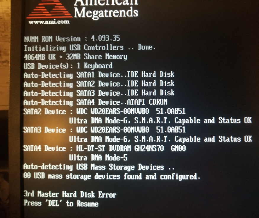

ive tried various people and they have flaked out on me. is it important? no as it is just another way to watch movies and store pictures. i lost internet this week, so it has bumped up my list. no netflix = no tv. i dont have a monitor attached to it. it boots up and runs. it has to run for some reason for me to be able to get internet to my TVs. this is just a hardware issue i am sure. but need someone to come look that knows what they are looking at.
You probably think way too highly of your local shop if you think they'll get you out of this one in an objectively satisfying way.
Press Delete to ignore the warning and show us what version of FreeNAS you have. If it even boots, that is - you only have two disks (and a DVD drive, for some reason) and no USB Mass Storage devices.

From this picture I see:
  • One unidentified SATA device (SATA1)
  • One drive tagged as having an error ("3rd Master")
  • The use of IDE compatibility mode for SATA ports rather than AHCI
  • WD Green (EARS) drives likely with a sky-high load cycle count
  • No USB drives to boot from (did you remove the stick to plug in the keyboard?)
  • 4GB of RAM
  • I'm guessing a very old version of FreeNAS
  • And a partridge in a pear tree
Taking all bets, but this thing is in a royal mess, especially given that it "hasn't worked in two years" according to your comments.
You may be able to use a very old version of FreeNAS to reinstall onto a fresh USB stick and see what's what, but frankly - how do you know this is even a FreeNAS machine? Unless it was set up in a very ill-advised and unsupported configuration, there's no reason it should need to run in order to give your smart TVs Internet access to get to Netflix.

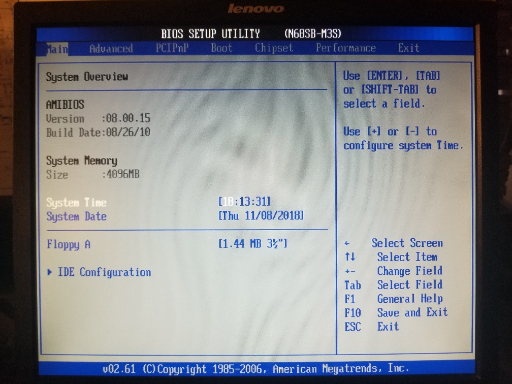

there was never a usb stick in the machine. so no clue what that is all about. i have no clue how it was set up. but it is running freenas. i will post the second screen shot.
