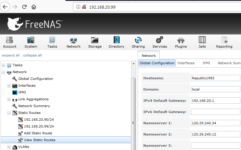

Below can be found an attached screengrab of the IP addresses being used.
I have configured the NAS for a static IP address, the default gateway was adjusted as required. I haven't touched the nameserver IPs since
it was first set up.
Am I able to check the logs through the webGUI somehow?
