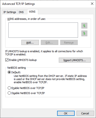

Even with no WINS servers, you have to actively disable NetBIOS over TCP:
And yes, it's a good idea to make the FreeNAS server the master browser, unless you already have an existing Windows master browser.

Stupid me... my WINS tab with one level deeper. Now I have disabled Netbios as well.
