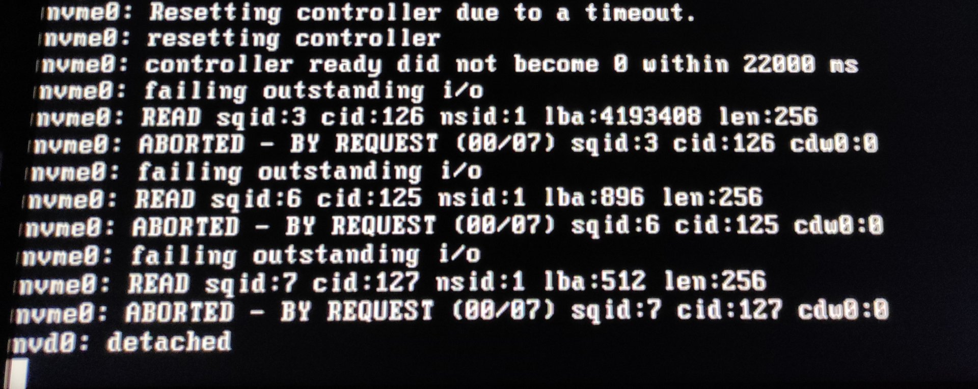

Attached.
When I initially added the device as a pool, I got a similar error about the device, but it worked on retry. My server worked until my PSU died and my mobo's sata ports stopped working so I upgraded the motherboard. Now on my new motherboard, my HDDs and SSD both work fine, but the NVMe doesn't want to import in FreeNAS. :( Tried in M.2 slot and PCIE card slot, same result. Went thru bios, can't see any settings that would impact this NVMe...
Any ideas?

Some technical info:
512GB WD Black PCIe Gen3x4 NVMe SSD
Mobo: Asus Z97-A
Can't get FreeNAS to boot without the above attached errors. If I take it out of the mobo, everything is fine.

Intel NVME device? Do a firmware update. We had the very same problem with our main FreeNAS servers @work.
Additionally make sure you run at least 11.3-U3.2, Warner Losh fixed a lot abot the NVME subsystem that is not in e.g. 11.2.
If all else fails try TrueNAS Core 12.0 beta, but don't upgrade your pools so you can rollback.
HTH,
Patrick
What do you mean by a firmware update? Bios is up to date. Is there firmware for the NVMe device itself somewhere?
The pool was made on 11.2 (or maybe 11.3-U1?), FreeNAS version I'm running now is latest.

If it's Intel devices, yes, there are firmware updates for NVME drives and that fixed the problem for us. BTW, Samsung, Crucial ... all the same. Regular firmware updates to fix drive issues.

Fixed it! Ran WD's firmware software (SSD Dashboard), updated firmware. NVMe loads fine!
Only problem now is that my jails/plugins don't show up. Could it be because the system ran on 11.3-U1? Now the system version is 11.3-U3.2. Is there a manual way to update to get my plugins/jails back?
