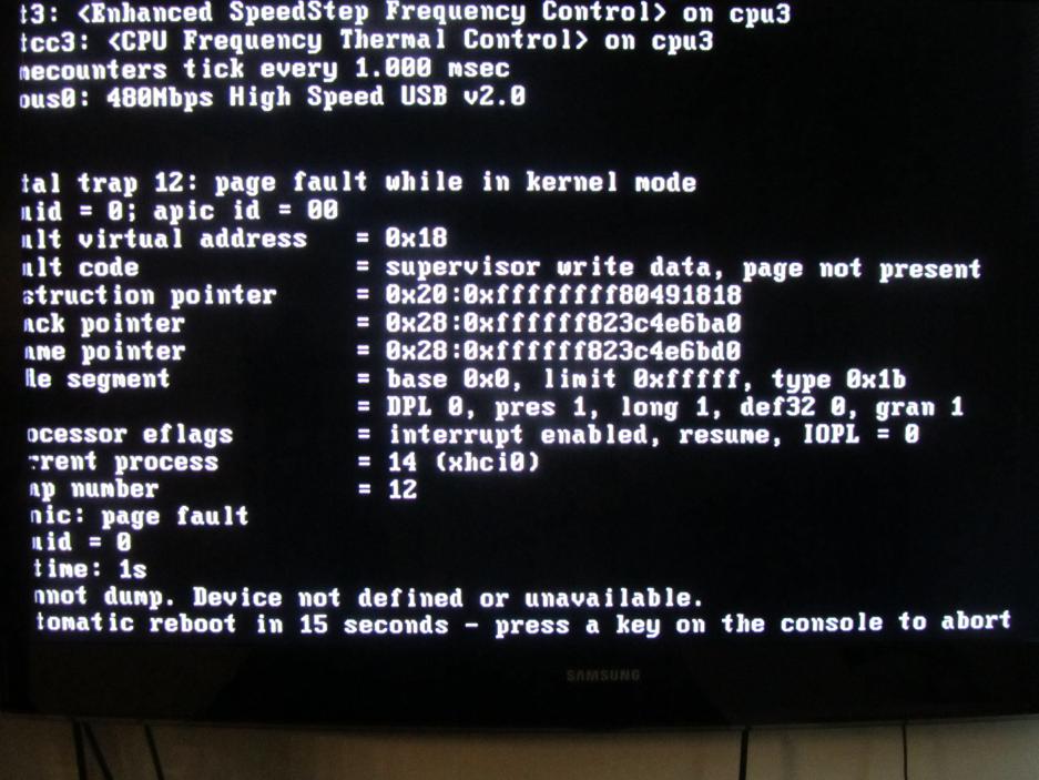

Here's the error code I'm getting.
Note, the motherboard only has a HDMI out (no video card), and the only terminal I have that can accept HDMI is a 46in TV. It seems to cut out 1-2 letters from the left.
geronimo1958
Nov 19, 2011
112
That looks like my error
as well. I have toggled a bunch of setting in the BIOS. Upgraded to the latest BIOS.
Ubuntu 11.10 64-bit is up and running. Memtest ran overnight.
Looking like it is FreeNAS 8 and Gigabyte Z68 not playing nice.

geronimo1958
Nov 19, 2011
112
I disabled the USB 3.0 in the BIOS and now the system boots OK and I am able to see it thru my web browser on my main system.
I will really need the USB 3.0 at some point. Backing up thru USB 2.0 is way too slow.
amitkhas
Oct 28, 2011
49
That did the trick for me too. I disabled the USB 3.0 controller in BIOS, and it booted like it should!
Though, kind of annoying... USB 3.0 speeds are a lot faster...
