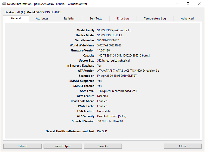

Just remembered I havea Windows 10 partition, so have fired that up and connected the disk.
Reformatted as MBR and it is visible to Windows 10 smartctl
C:\Program Files\smartmontools\bin>smartctl.exe -i /dev/sda
smartctl 7.0 2018-12-30 r4883 [x86_64-w64-mingw32-w10-1803] (sf-7.0-1)
Copyright (C) 2002-18, Bruce Allen, Christian Franke, www.smartmontools.org
Model Family: SAMSUNG SpinPoint F2 EG
Device Model: SAMSUNG HD103SI
Serial Number: S210JDWZ309537
LU WWN Device Id: 5 0024e9 00329fb33
Firmware Version: 1AG01120
User Capacity: 1,000,204,886,016 bytes [1.00 TB]
Sector Size: 512 bytes logical/physical
Device is: In smartctl database [for details use: -P show]
ATA Version is: ATA/ATAPI-7, ATA8-ACS T13/1699-D revision 3b
Local Time is: Thu Apr 25 20:11:49 2019 GMTST
SMART support is: Enabled
This looks good. So now to power down and move disk across (again).

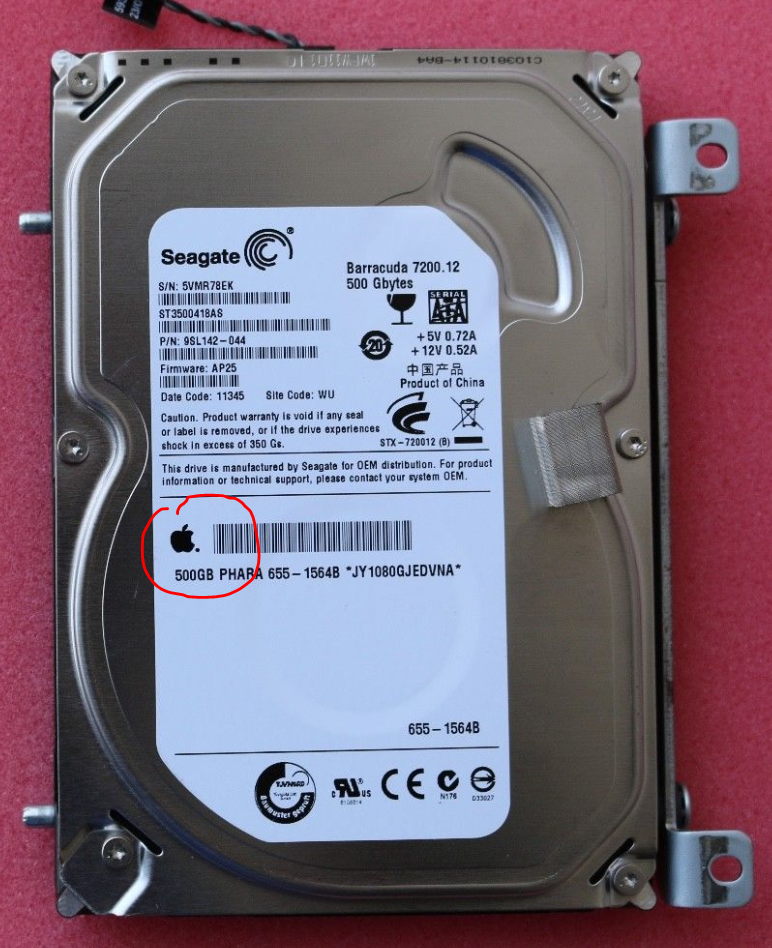

I'm wondering if this is a special 'Apple' disk with odd (or non existent) firmware, I know Apple does stupid stuff like this,
Does this disk have an Apple logo on it like the one below? There is such a thing as disks that are made with custom firmware for Apple.
Example:
I have not had to deal with that kind of hardware since the late 90s, because I have been working in a place where we don't do Mac, but it once was the case that a Mac would not boot from a drive that was not Mac Specific and it could tell because the drive had custom firmware.
I'm going to power down again, add it back to the Mac, power up VMWare fusion, run Windows 10 and reformat the disk as MBR (or anything that's not Mac).
If the reason the drive isn't working in FreeNAS is down to some custom firmware in the drive and you are booting from a dual boot utility on Mac hardware, your Mac hardware Is still handling the firmware of the drive and is the thing allowing Windows to access the drive. This proves nothing.
I'm getting tired of starting and stopping machines to work this out. I would have thought that the Dell T110 ii would at least know there was a disk attached even if it couldn't read it.
Not if the drive has some crazy Mac specific firmware that the Dell doesn't know how to access. This is NOT a problem with any component other than the drive.

It does have the Apple logo.

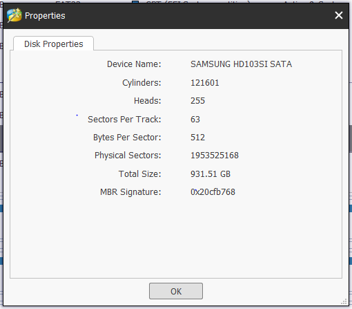

Just fired up a native (non VMWare Fusion) Windows 10 partition again and had a look at the disk with MiniTool Partition Wizard. I can partition the disk, format the disk as MBR, I can create files and directories.
The sector size is 512 bytes so the thought it might be some stupid sector size is not the problem.
I also checked with gsmartool which is a nice interface to smartmontools and it all looks fine
