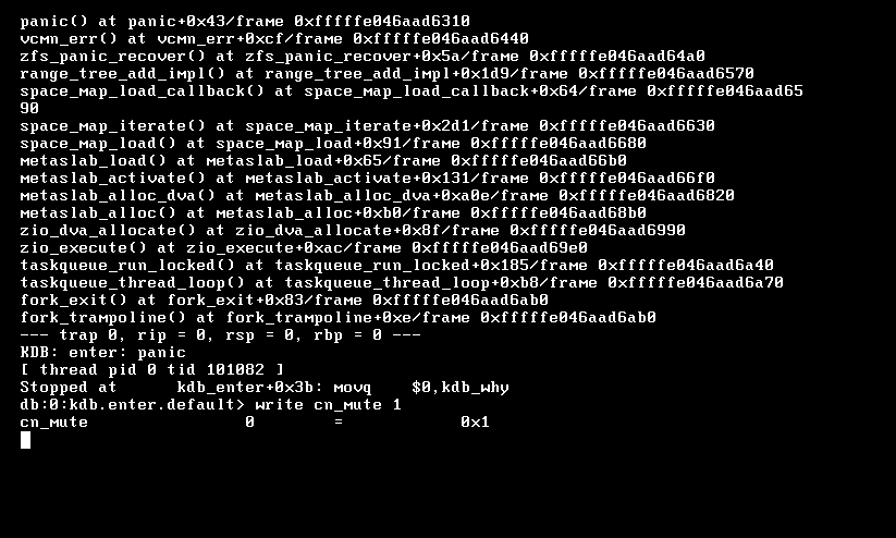

Hi running into an issue here with my working FreeNAS setup and now stuck in a boot loop. I was trying to do a network backup and after which my FreeNAS became stuck in a boot loop with the following images below. It seems to be related to trying to load the RAID-Z pool. When I boot FreeNAS as initial install it boots fine. I go in and try to import the existing pool, the console window loads the following and then reboot. This is a FreeNAS setup that has been working for quite some time and the drives seem to be fine. I am running it in ESXi. I have tried reduceing the memory allocation, and vCPUs with no positive results. Any thoughts?

HoneyBadger
actually does care
Administrator
Feb 6, 2014
5,112
Did you connect the drives via an HBA in PCI passthrough mode, or is VMware in the way in any manner (virtual disks, local RDM, etc?)
Also, please post full hardware specs.

HoneyBadger
actually does care
Administrator
Feb 6, 2014
5,112
Check the model of your WD drives against the list of known SMR drives, there's some firmware issues that could contribute to this. Non-ECC RAM could also be a culprit.
The short version is that it looks like your pool is corrupted. If you have a backup, restore from that. If not, read on.
(If this is irreplaceable data then start by block copying your drives using dd or a similar tool. Only work on the copies.)
With your pool exported, try using zdb -e RAIDZ -ul to list potential previous uberblocks and their transaction groups, then zpool import -F RAIDZ -T 12345678 -n -o readonly=on with an actual txg number in place of the filler number. If it says it will work you can try removing the -n to make it do it for real, check the contents to make sure things are there, and then either copy everything off, or export and import again without the readonly flag to actually do the rollback.
