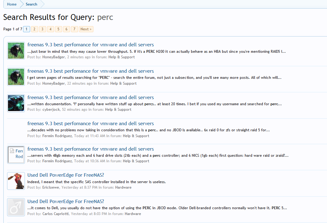

Sep 23, 2013
35
then theres something wrong with the indexing.
HoneyBadger
actually does care
Administrator
Feb 6, 2014
5,112
I get seven pages of results searching for "PERC" - search the entire forum, not just a subsection, and you'll see many more posts. All of which will probably tell you the same thing - don't use this card unless it's been reflashed to IT mode.
