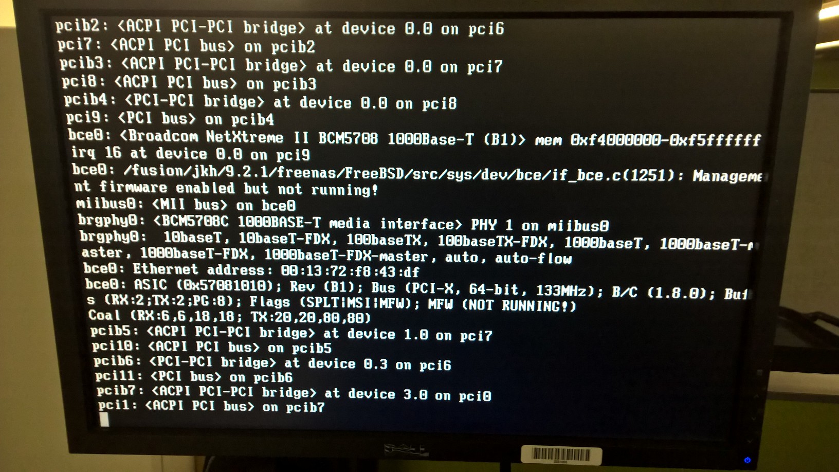

SOLVED FreeNAS 9.2.5.1 fails on pci1 ACPI pcib7
Mallo
Sep 15, 2015
I was following the guide for the AD file and folder permissions here but I was using FreeNas 9.3.1. I was able to get 9.3.1 installed with no issues and start the configuration and get a lot configured except when it came to setting up the Windows ACL.
I then decided to attempt installing using the exact version of FreeNAS that is outlined in the guide. I reset the raid 1 array and wiped all partitions on the flash drive to give myself a true vanilla starting point. That is where I get stuck.
The system I am installing on is a Dell Poweredge 1950 server. Dual Intel Xeon Processors with 8GB of RAM, and a PERC 5i raid card.
Any assistance on getting FreeNAS 9.2.1.5 installed or if there is another guide for 9.3.1 to setup the Windows ACL's, I would appreciate any insight.
Screenshot of the frozen screen attached.
