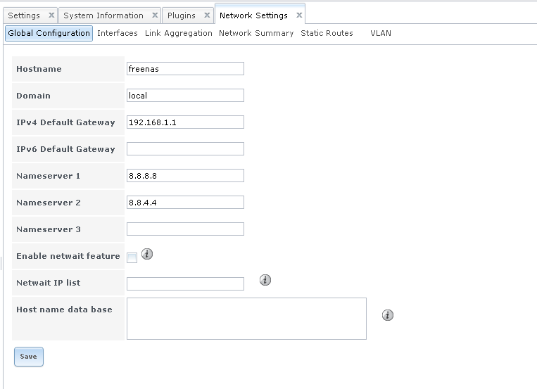

DrKK
FreeNAS Generalissimo
Oct 15, 2013
3,630
No, I understand that you have them listed in there, but they are NOT being used. Check the actual physical contents of the /etc/resolv.conf file, and tell us what it says.
shackrock
Dec 21, 2011
95
Here it is:
search local
nameserver 8.8.8.8
nameserver 8.8.4.4
I wonder if it's possible to reset all network settings to factory default again, maybe something is weird in here after my upgrade to 9.2?
