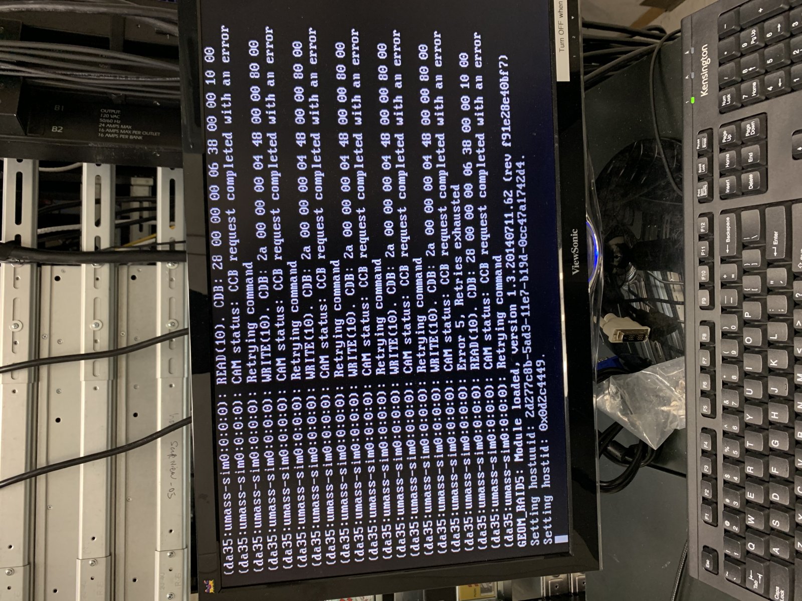

Hey all!
I have a server with known failing disks that we’ve been “managing” for some time now.
The device power cycled by itself probably cos it’s overloaded and now it won’t boot. See attachment for error.
Side note: I’m a Network Admin and this isnt my strongest suite.
Thanks in advance!

Is there a way to retrieve what was configured on the usb stock with damaged FreeNAS?
Take a look at posts 27 and 30 in this thread - https://www.ixsystems.com/community/threads/help-upgraded-to-11-2-can't-boot-up-server.75003/page-2#post-521155
Also some of the links there - this one, for instance https://www.ixsystems.com/community/threads/update-went-wrong.74084/page-2#post-514298
Hopefully the instructions on the use of mc will work for you. You can use MC from the shell, but I find ssh to be better.
Also - you can get to that location from a Windows machine - using SSH that is built in to Win10 now, or with WinSCP, and others.

Really hoping to get this mess sorted out... I definitely appreciate the assistance!
I got to work not long ago, created a FreeNAS bootable drive, installed 9.10.2-U6 on a new disk, shut the system down, reconnected all the drives and fired the server up.
I'll share an update as soon as I have something solid.

The installation was pretty straight forward and i can access gui.
* I can view all connected disks, but nothing shows up in my pool
* Based on what was shared in the links above, I can see a config file in this directory. Is this possibly what I need to restore my configs?!
root@freenas ~]# cd /data
[root@freenas /data]# ls
crash           factory-v1.db   pkgdb           ssh
dhparam.pem     freenas-v1.db   pwenc_secret    zfs
dhparam1024.pem manifest        sentinels

I successfully imported pools, but it appears the config may have been lost. I uploaded the 'freenas.v1.db file, but it had the new config created today. Is it possible the config is on the old boot drive?

Good gracious! I think we're up to something here! Please tell me these are backup files!!
How can I download the file(s)?

20171009.db  20171225.db  20180312.db  20180528.db  20180813.db  20181029.db  20190114.db  20190401.db  20190617.db  20190902.db  20191118.db  20200205.db
[root@nas-devops-01] /mnt/volatile-01/.system/configs-4c6211b89a3046dfbe28e409c4a02537/FreeNAS-9.10.2-U6 (561f0d7a1)#
Alecmascot
Mar 18, 2014
1,177
OK. You have found what you needed to.
I think the thread I linked to takes you through how to save the .db file, unmount the pool, then upload the saved db file, as a saved config, through the gui.
sudo_bang
Jan 30, 2020
7
  • I was able to find the hidden file using WinSCP after I entered the path manually!
  • I moved too quickly and didn't unmount the primary volume before uploading the config, but that seemed to work without issues
  • Everything is back like it never went down - I'm ecstatic to say the least!!
    Now just need to figure out how to mirror the boot drive. I was moving so quickly, I didn't bother doing it in the beginning.
    Thank you @Redcoat @Alecmascot!!!
