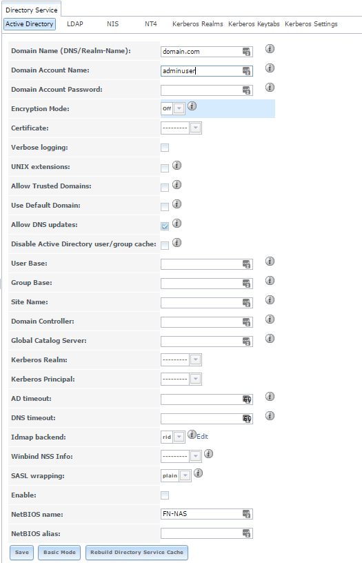

I have installed the FreeNAS-9.10.2-U1 version, setup the network and am now trying to join it to the domain, however I am getting the following error:
  • '10.100.1.0/24\nCNF:c61ce50d-0e0f-4289-bb7b-a73a873afa33' does not appear to be an IPv4 or IPv6 network
this error appears when trying to enable the Active Directory Page.

See below, I've changed the domain and username but everything else is as is. Thanks
