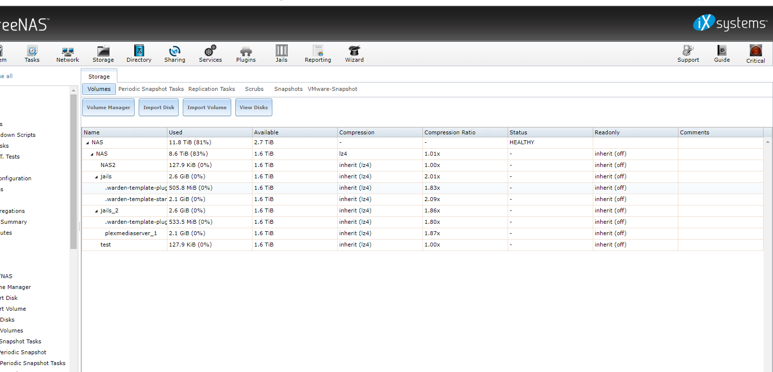

FreeNAS-9.10.2 disk replacement
I’m bit out of my depth here I’m trying to replace my drive but my screen looks nothing like the examples or the documentation, any idea how I replace my drive ?
Looking to replace this drive ..

Any pointer appreciated, do not see an option to take my drive offline on the GUI ?
You need to be on the volume status page, not the view disks page. In addition to the manual linked above, you can also see this resource:
