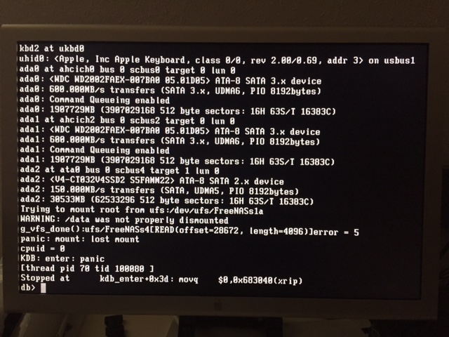

Hi all, this is my first post here. Unfortunately its to ask for help. I built my freeNAS server a couple years ago and pretty much didn't touch it since then. I came home to find it like this the other day and I have no idea where to start. I did some searching but couldn't find anything obvious.
I'm running an AMD mobo, crucial SSD for the OS, and WD black drives for storage. I have not had to troubleshoot anything since I built it, it just worked. I am a complete noob.
I'm really hoping my pools are ok and I'd like to upgrade to 9.3 assuming my hardware will work. I see AMD is absolutely not recommended but I must have gotten lucky the last couple years.
Please help! Thanks in advance

How much RAM, and what filesystem is your data volume? If the former is less than 8 or 12 GB, or the latter is UFS, you aren't a good candidate for 9.3. For now, try a fresh installation of 8.2 to a new USB stick, and import your saved backup config file.
+1
The picture indicates failure to mount the ufs device which should be your boot drive.
Forget upgrading to 9.3 for now, your configuration file can be found on the pool,
but first you have to get it mounted before you can pull off a copy. Follow danb35's advice.

The configuration file is on the 4th partition of your boot device. The file name is: freenas-v1.db
If you can rescue the file from your old boot device, you can use the webGUI to restore it.
