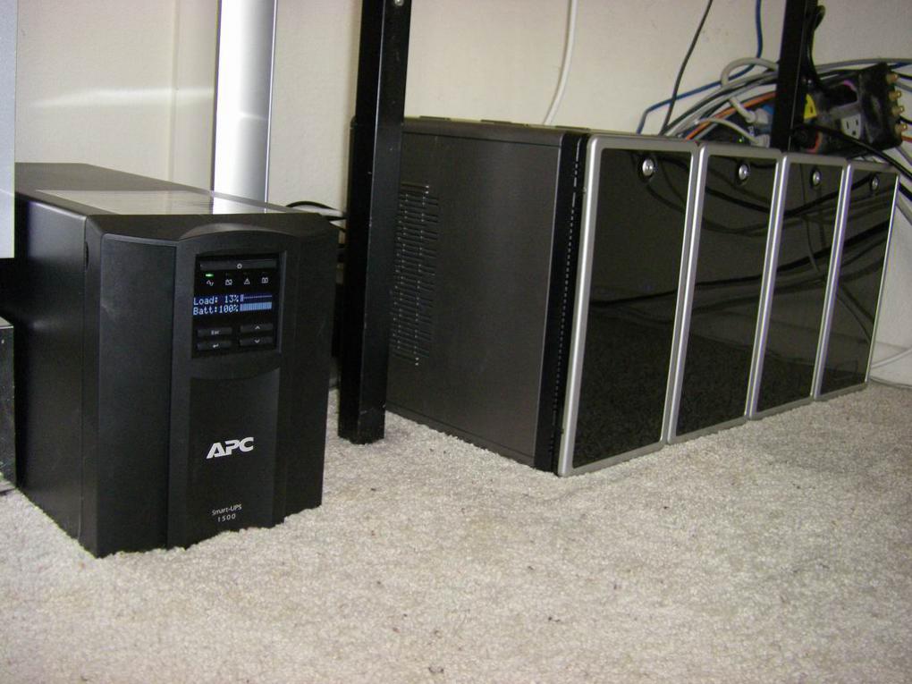

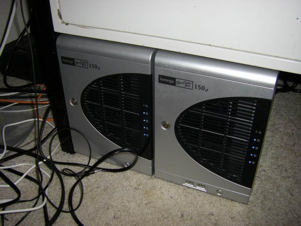

Yes, my secondary system (the one that receives an rsync incremental backup every night) is identical to the primary system. Both are setup as 2-disk MIRROR filesystems in ZFS. The tertiary system (the offsite backup) is completely different. It is a commercial Iomega NAS, setup with an XFS filesystem in RAID-5 configuration.
I actually have another set of 3 systems for even more data. Two of those are FreeNAS 7 (running identical 4-disk ZFS RAIDZ), and the third offsite backup is another Iomega (4-disk XFS RAID5).
I've attached some NAS-p0rn for your enjoyment. The first picture is my 4 FreeNAS systems and the UPS they're plugged in to. The second is the two Iomega NAS systems.
