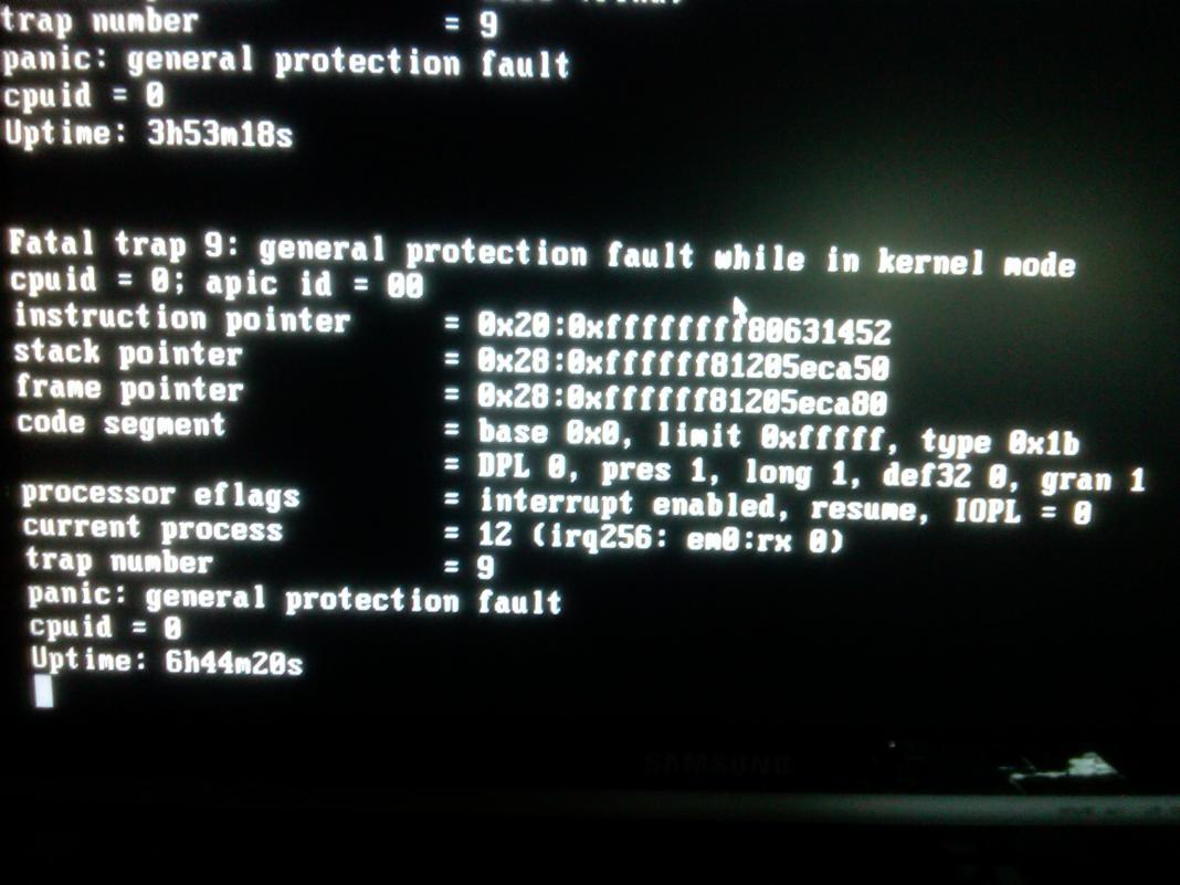

Hi Everyone,
Currently I am testing Freenas 8.0 amd64 Release but getting a Fatal trap 9 issue after 3-6 hours.
Current hardware:
SUPERMICRO MBD-X7SPA-H-O Intel Atom D510 1.66Ghz Server Motherboard
4GB SO-DIMM DDR2
Chenbro case with 4 removable trays
4X1TB WD1001FALS (with TLER enabled)
The error message I am getting is:
Fatal trap 9: general protection fault while in kernel mode
cpuid=0; apic id=00
instruction pointer = 0x200:0xffffffff80631452
stack pointer = 0x28:0xffffff81205eca50
frame pointer = 0x28:0xffffff81205eca80
code segment = base 0x0, limit 0xfffff, type 0x1b
= DPL 0, pres 1, long 1, def32 0, gran 1
processor eflags = interrupt enabled, rersume, IOPL=0
current process = 12 (irq256: em0:rx 0)
trap number = 9
panic : general protection fault
cpuid = 0
Uptime: 6h44m20s
Initial Freenas setup is fine. I was able to get to the Freenas management console. Add the 4 drives as ZFS Raidz single volume. I add some data to the volume. Then I leave it there for a while and when I come back a few hours later, I would get the Fatal trap 9 error.
My other test to see if it was the hardware, I replaced the drives with (4) WD VelociRaptor WD3000HLFS. Create the same ZFS Raidz single volume. Copy some data on there and it ran fine without errors for over 24 hours.
So my question is has anyone successfully run Freenas with WD WD1001FALS drives? Or is this error relate to other hardware issues.
Any suggestions would be appreciated.
Thanks...

TwinDaddyKev
Jul 20, 2011
27
I actually tried it with 8.0 Release and 8.01 Beta 4 and get the same error message. The weird thing is when I tried the WD3000HLFS VelociRaptor drives, I don't get this issue.
I'll try changing the vm.kem_size setting you suggested.
Thanks for your help.
TwinDaddyKev
Jul 20, 2011
27
Thanks in advance for your help protosd. You've been a great help and a great contributor to this forum.
As for my issue, I may be having hardware issues. I tried the zfs tuning as you suggested running on FN8 release and FN8.01 Beta 4 but it still crashes. But this time, the web GUI crashes saying it's not available. I can ping the device but can't access it via web GUI or SSH into it. I also tried running it without any hard drives installed except for the 4GB USB drive running FN8.
I am getting a GEOM: ad0s1: geometry does not match label (255h,63s != 16h,255s). And I tried different USB drives and still get this GEOM error. How are you booting on your device and are you getting this GEOM error?
This leads me to believe that the hardware could be an issue. Maybe there is something wrong with the memory modules. Also the BIOS is up to no good. I tried to change the time in the BIOS but it never save. It's always 8 hours ahead for some reason. I flashed it with the latest BIOS firmware R 1.1a but it still didn't fix the time issue.
I am going to run a memory test later today to see if I can find any errors.

TwinDaddyKev
Jul 20, 2011
27
Just an update on my issue. It turned out that one of my sodimm is bad. I did a test on it and there were bunch of errors. I also test the other sodimm and it was good. I guess it's time to buy more ram.
