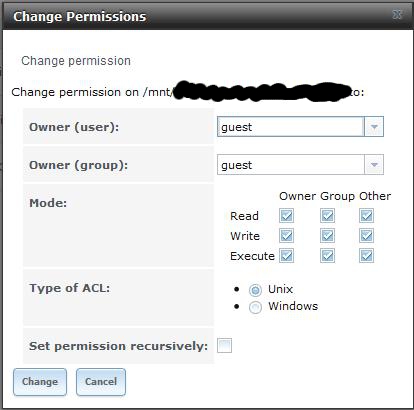

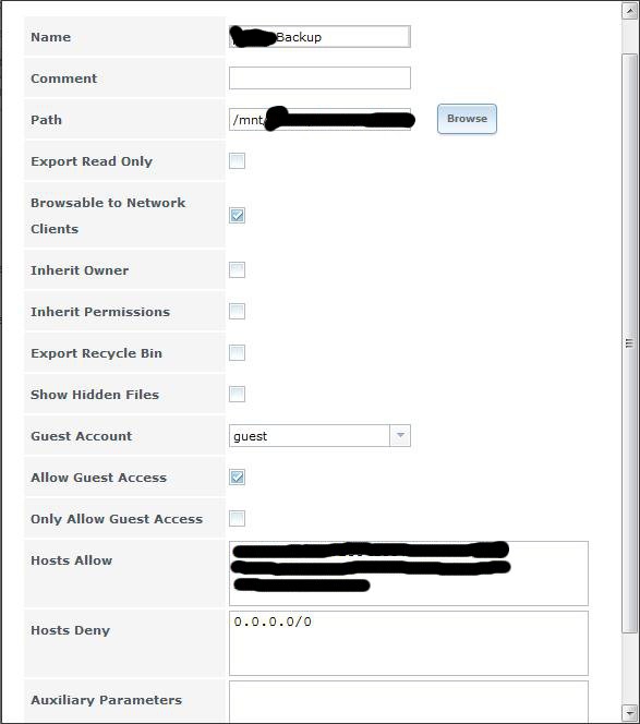

Let's call this Share 1 and this is the anonymous access. Here is the volume permissions and the cifs share settings.

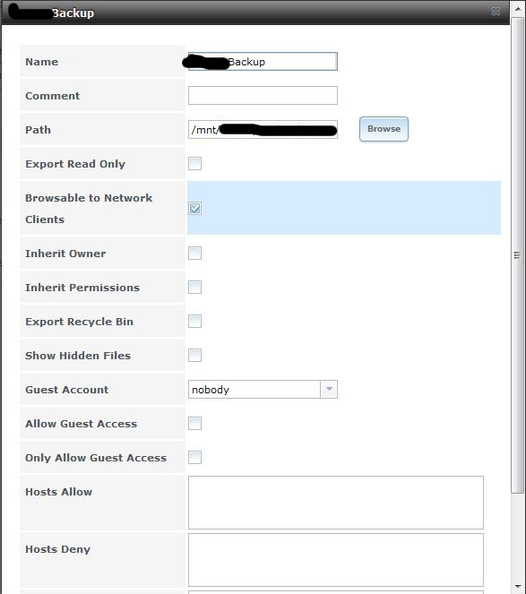

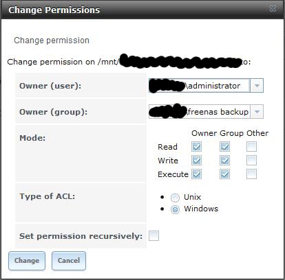

This would be Share 2 and this has the ldap permissions
So far I have tested across the network and the machines with the ip are able to access anonymously like they need to and those that are not included in that ip list cannot access that share. The same is true for the second share that only those in that freenas group are able to access that share as well. Obviously the only reason this works is by turning on other permissions for read/write/execute on the anonymous share from what I understand. Any thoughts or concerns?
