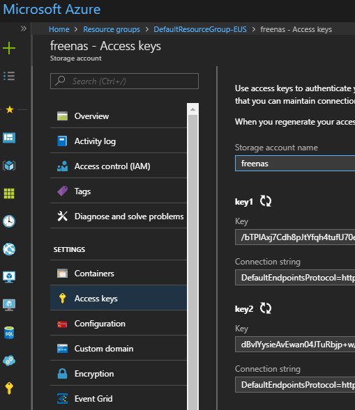

I'm interested in adding some Azure Blob storage as a dataset in FreeNAS-11-Nightlies. I assume I start by making some cloud credentials, but the Account Key has me confused. I see nothing like this terminology in Azure. What am I looking for?

OK, not obvious to me but I'm new to Azure. This lets me do a "Cloud Sync", not mount it as a dataset.
Select your resource group you made the blob in, then along the left you should see "Access Keys".
