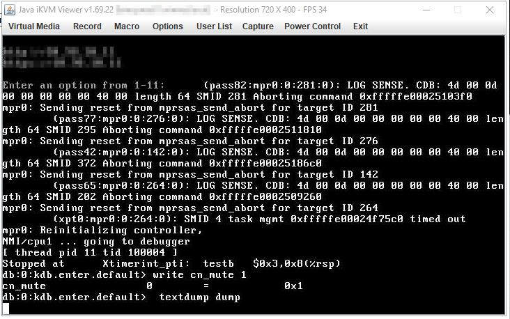

have updated to FreeNAS 11.3 on two different SuperMicro boards. One board is X9 and the other is X11.
They were running fine on 11.2U7 for months. Since updating to 11.3, they are both rebooting randomly.
The IPMI shows this in the logs
X9
X11
Both IPMI firmwares are up-to-date.
Watchdog is disabled in BIOS. We tried to disable watchdog in FreeNAS (watchdogd_enable = NO in rc.conf) but we still get these reboots.
Can watchdog be disabled completely? Anything else i can try?
X9
| 79 | 2020/02/13 23:25:53 | OEM | CPLD | CATERR - Asserted |
| 78 | 2020/02/13 19:51:12 | OEM | CPLD | CATERR - Asserted |
X11
| 160 | 2020/03/11 21:04:56 | Watchdog 2(OEM) | Hard Reset - Interrupt type: None, Timer use at expiration: SMS/OS - Assertion | ||
| 159 | 2020/03/11 21:04:55 | Watchdog 2(OEM) | Timer interrupt - Interrupt type: None, Timer use at expiration: SMS/OS - Assertion | ||
| 158 | 2020/03/11 21:00:17 | Critical Interrupt | Bus Uncorrectable Error@Bus17(DevFn00) - Assertion |
