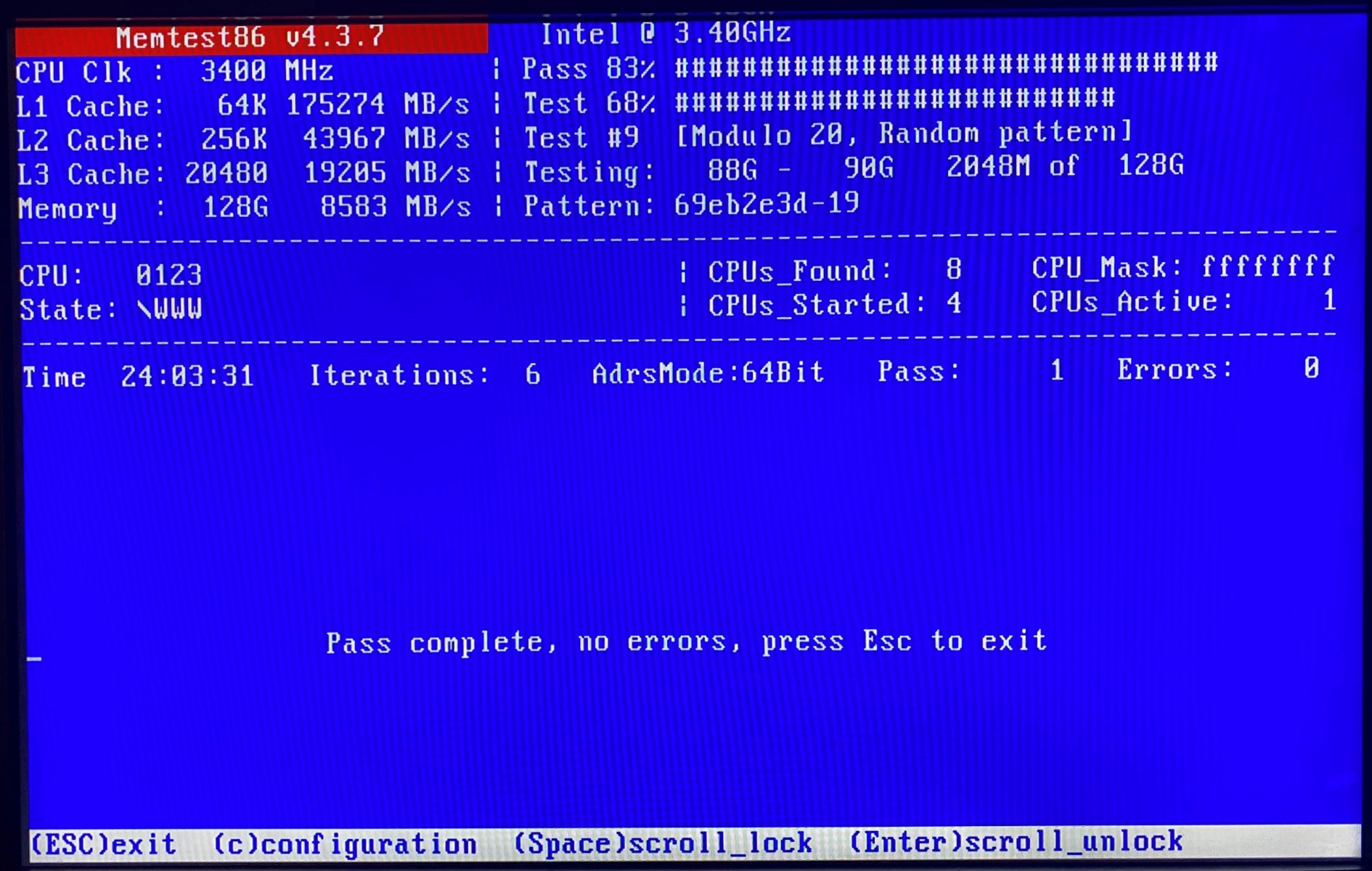

Memtest86 run for 24 hours and no Errors

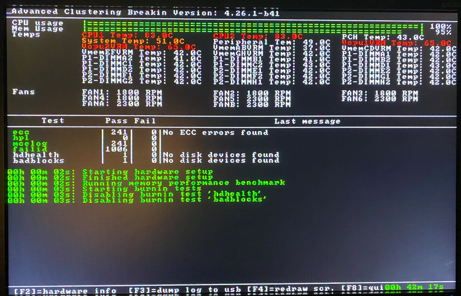

run Breakin for about 40 minutes and no errors. Processor Temp were high but still no errors.
