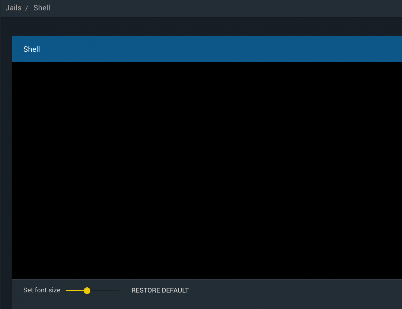

Back to the original issue of the jails not working. This is all I see when I shell into a newly created 11.2 jail:
From the FreeNAS shell I can execute iocage exec {jail} ls and it will give me a list of files as expected. So something is working.

I'm getting this from /var/logs/messages:
ec 25 18:54:36 test newsyslog[87529]: logfile first created
Dec 25 18:54:36 test syslogd: kernel boot file is /boot/kernel/kernel
Dec 25 18:54:45 test login: in openpam_check_desc_owner_perms(): /etc/pam.d/login: insecure ownership or permissions
Dec 25 18:54:45 test login: pam_start(): system error
Dec 25 18:59:57 test rtsold[87335]: <rtsock_input_ifannounce> interface epair0bremoved
Dec 25 18:59:57 test dhclient[87266]: connection closed
Dec 25 18:59:57 test dhclient[87266]: exiting.
Dec 25 18:59:57 test syslogd: exiting on signal 15
Dec 25 19:00:24 test syslogd: kernel boot file is /boot/kernel/kernel
Dec 25 19:00:28 test login: in openpam_check_desc_owner_perms(): /etc/pam.d/login: insecure ownership or permissions
Dec 25 19:00:28 test login: pam_start(): system error
Dec 25 19:03:57 test dhclient[88850]: connection closed
Dec 25 19:03:57 test dhclient[88850]: exiting.
Dec 25 19:03:57 test syslogd: exiting on signal 15
Dec 25 19:04:00 test syslogd: kernel boot file is /boot/kernel/kernel
Dec 25 19:04:04 test login: in openpam_check_desc_owner_perms(): /etc/pam.d/login: insecure ownership or permissions
Dec 25 19:04:04 test login: pam_start(): system error
Dec 25 19:06:12 test dhclient[90156]: connection closed
Dec 25 19:06:12 test dhclient[90156]: exiting.
Dec 25 19:06:12 test syslogd: exiting on signal 15
Dec 25 19:06:15 test syslogd: kernel boot file is /boot/kernel/kernel
Dec 25 19:06:18 test login: in openpam_check_desc_owner_perms(): /etc/pam.d/login: insecure ownership or permissions
Dec 25 19:06:18 test login: pam_start(): system error
Dec 25 19:07:45 test login: in openpam_check_desc_owner_perms(): /etc/pam.d/login: insecure ownership or permissions
Dec 25 19:07:45 test login: pam_start(): system error
Dec 25 19:11:56 test dhclient[91201]: connection closed
Dec 25 19:11:56 test dhclient[91201]: exiting.
Dec 25 19:11:56 test syslogd: exiting on signal 15
Dec 25 19:11:59 test syslogd: kernel boot file is /boot/kernel/kernel
Dec 25 19:11:59 test limits: _secure_path: /etc/login.conf is world writable
Dec 25 19:11:59 test limits: login_getclass: unknown class 'daemon'
Dec 25 19:11:59 test /usr/sbin/cron[93128]: _secure_path: /etc/login.conf is world writable
Dec 25 19:11:59 test /usr/sbin/cron[93128]: login_getclass: unknown class 'daemon'
Dec 25 19:12:02 test login: _secure_path: /etc/login.conf is world writable
Dec 25 19:12:02 test login: in openpam_check_desc_owner_perms(): /etc/pam.d/login: insecure ownership or permissions
Dec 25 19:12:02 test login: pam_start(): system error
Dec 25 19:18:24 test syslogd: exiting on signal 15
Dec 25 21:51:21 test syslogd: kernel boot file is /boot/kernel/kernel
Dec 25 21:51:24 test login: in openpam_check_desc_owner_perms(): /etc/pam.d/login: insecure ownership or permissions
Dec 25 21:51:24 test login: pam_start(): system error
Dec 25 21:51:56 test login: in openpam_check_desc_owner_perms(): /etc/pam.d/login: insecure ownership or permissions
Dec 25 21:51:56 test login: pam_start(): system error
LQkkeN
Dec 25, 2019
12
I was able to fix this by revoking group write access on the jail dataset.
