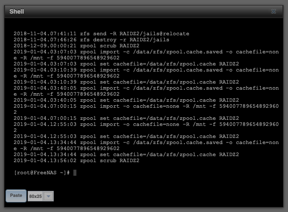

Not running snapshots. Allocated space is unchanged. Attached is zpool history.
Please review this thread: https://forums.freenas.org/index.php?threads/lost-data-in-upgrade-to-11-2.71585/
And this bug report: https://redmine.ixsystems.com/issues/64512

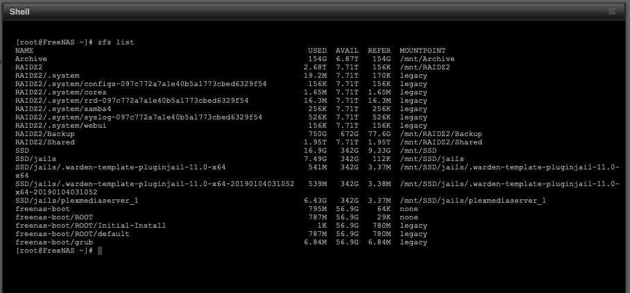

Also, tell us as much as you can about your system. If possible, include a debug tarball. Before you do that, though, please clarify with the output of zfs list: How much space were you using before and how much space are you using after your data disappeared. (If the answer is "the same in both cases" you didn't lose data and have a dataset mounted on top of a directory or vice-versa due to a misconfiguration.)

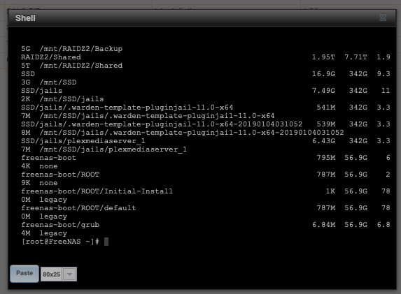

I had more than 50% of a 12TB pool utilized or ~5-6TB used (5x4TB WD Red drives in RAIDZ2 configuration) and I am now seeing 1.95TB...

@wlagarde, the part I am puzzled about in you screenshot if the "zfs send -R RAIDZ2/jails@relocate" without the "zfs receive" command being followed.
After which the "jails" dataset is being destroyed recursively which means that all its descendant children dataset are going to be destroyed as well.
Could it be the source of your problem?
The allocated sie of 1.95TB is only for RAIDZ2/Shared. It may not describe the entire Pool alloaction as each dataset may have been assigned Quotas, or simply a datset where descentent dataset exist, the parent will provide the cumulative allocated space for the descendant only.
If that makes sense to you.
I had my plexmediaserver pointing to the "Movies" folder and the "TV Shows" folders; however, the TV Shows are there while the "Music: and "Movies" folders are missing. Also to clarify I made no changes to my jails.
