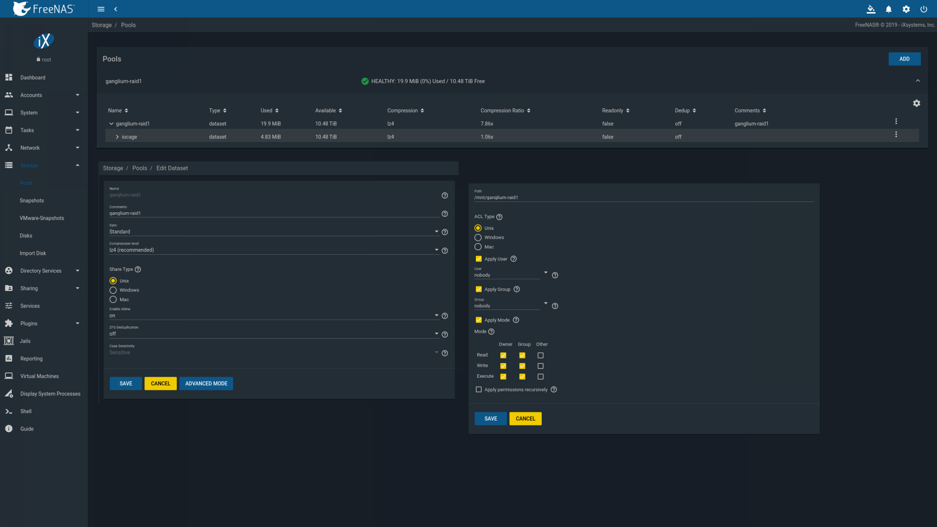

I have built and setup freeNAS server (hostname ganglium). The pool is set as follows, the pool owner is the nobody and group is also nobody.
I plan to share it via SMB and via nfs. SMB sharing is succesfull and appears to work without troubles. The used SMB settings is listed below.

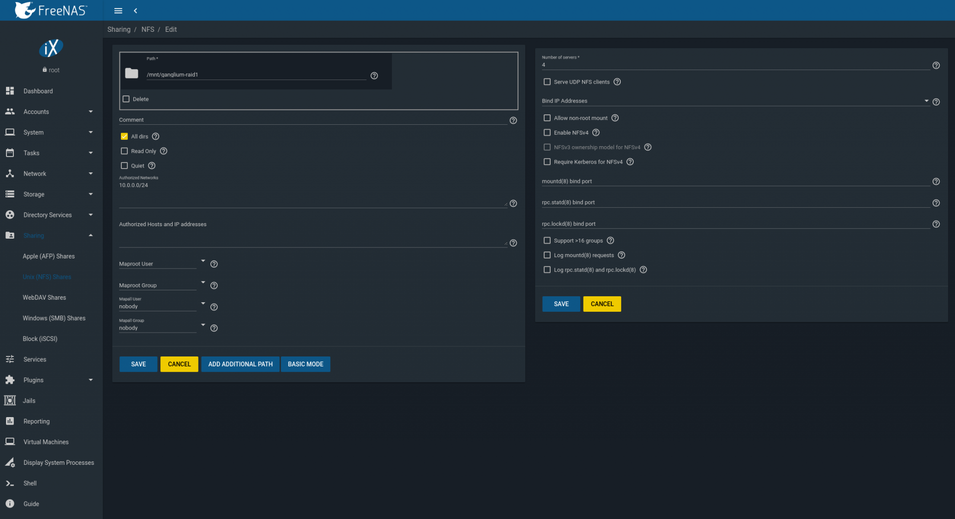

For the nfs setting, I have read or watched several instructions/tutorials, e.g. [1,2,3]. I have selected to use the freenas documentation instructions [1] and have set the NFS as follows:
The mount has passed succesfuly, but I am not able to read what is inside the ganglium-raid1 folder from my Ubuntu machine (hostname dendrit):
labounek@dendrit:~$ sudo mount -t nfs ganglium:/mnt/ganglium-raid1 /mnt/ganglium-raid1
labounek@dendrit:~$ cd /mnt/ganglium-raid1/
labounek@dendrit:/mnt/ganglium-raid1$ ls -l
ls: directory is being reading '.': Operation denied
total 0
The user labounek has the same username and UID 1000 over both machines and is the member of groups nobody (GID 65534) and nogroup (65533) at the FreeNAS server. At the Ubuntu machine the group called nogroup with GID 65534 exists after system instalation, so I have set user labounek to be the member of this group at the Ubuntu machine. While the comunication should be GID sensitive and not group name sensitive, I believe different group names over machines for the GID 65534 should not matter. Am I right? If not FreeNAS and Ubuntu default GIDs are inconsistent.
I have also tried to set only the MapAll User at the root as suggested in [2,3] (MapAll GRoup was set as empty), and have set owner of the ganglium-raid1 folder at root user and wheel group. It helped that I was able to read inside the folder and write into the folder and its sub-folders. But the owner of new files or new folders was root at the FreeNAS server. I do not find it very useful and secure solution.
Please any ideas what could be wrong? I am not able to see it. I have also attached the debug file.

From your screen caps you appear to be (a) sharing the whole pool rather than individual datasets within it and (b) simultaneously sharing the same data via to different protocols, namely SMB and NFS. You need to re-think what you're doing.
1. Store your data in datasets
2. If you need to access the same data from both windows and linux clients stick to SMB only.
3. No need to add users to the nobody group
4. Your Pool mountpoint - /mnt/ganglium-raid1 - is best left as root/wheel for owner/group

ad 4. So why the FreeNas documentation is writing following step in the NFS configuration tutorial?
"In the Change Permissions screen of the pool or dataset that is being shared, change the owner and group to nobody and set the permissions according to the desired requirements."

Point 1. The top level of your pool needs to say as root/wheel for owner/group, so you should at least create one dataset below /mnt/ganglium-raid1 on your pool. But treating/thinking of your data as one big drive means you may not be using the full potential of zfs. Have you never used multiple partitions on a linux machine or windows were the data is partitioned and appears on separate drive letters as you want to divide your data by usage, owner or frequency of update for example? As each dataset created on a pool is a separate filesystem you can think of this as partitioning your data. You can vary the zfs properties of each dataset: eg. owner/group, quota, reservation, recordsize, snapshot frequency, share type, etc.

Point4. The FreeNAS document is repeating advice for insecure NFS shares that do not use kerberos. It may not be convenient to use this method, but you can google that idea.

Ad 4. If NFS would be still actual, I will try to make it work with root/wheel for the ganglium-raid1. But I am still unsuccessful. I do not think kerberos authentification is necessary for home non-commercial NAS server. If we would make the public IP address, I think restricted list of allowed MAC addreses enabled to connect to the server and BAN after 5 unsuccessful logins could be enough security bridge. I believe FreeNas is enabling to setup both. What do you think?

Point 1. Perhaps there is a misunderstanding here. Using multiple datasets in a single pool is like having several partitions on one large hard drive, not creating multiple hard drives (HDD). I would encourage you to read about zfs datasets before you load data onto your pool, look at the “zfs primer” in the FreeNAS guide, the FreeBSD handbook https://www.freebsd.org/doc/handbook/zfs.html and google the subject.

Point 4. You really should be sharing one or more datasets, not the pool which is what you are doing by referencing /mnt/ganglium-raid1. Setting up kerberos is a non-trivial exercise, so is possibly over-kill for a home lan network. I suppose it all depends on your level of paranoia and what other security measure you have in place and access controls. As each dataset is its own filesystem, you have some additional control over access by using multiple dataset, as each requires a separate NFS share definition.
