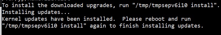

Login as root and do.... iocage upgrade examplejail -r 11.3-RELEASEHow have you upgraded the Jail Release to 11.3?
As earlier described - I ended up terminating the update process after seeing this prompt just hanging with a message of re-booting the system and then apply the update....
I since discovered that this message is bollocks, where giving it enough time it will complete the process successfully.

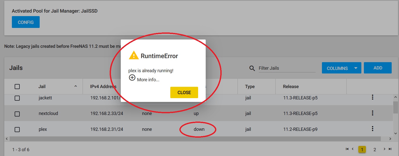

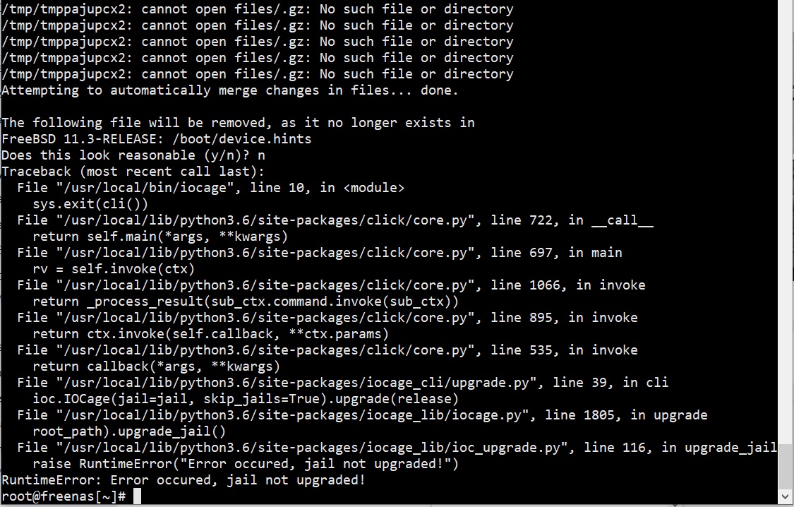

BUT(!), now Im stuck with my plex jail stuck on the previous jail version and when I try to do the update again I received this message...
Answered 'n' to the first prompt and the update failed - now I can't start the jail again - When trying to start it the message spat back said "Its already running" - even though the console thinks its down with NO option to stop it.
According to doco you can apply the update with the jail running or shutdown - either way.is it necessary to stop the jail or can it be done while it's running.
You've got some other issue going on. I've upgraded all my jails that are currently running from older versions and I've never been prompted to reboot the jail or the server.The jail update process would gain by adding something showing its still processing stuff instead of suggesting a reboot and separate update once back
